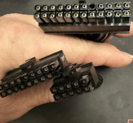

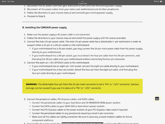

Hi, I’ve bought a RM650 — 650 Watt 80 PLUS PSU to use with an Amiga 3000. The instructions say the 24 pin power connector can made a 20 pin connector as it’s modular. But my cables have no such function? I need the 20 pin to use the A3000 power adapter. I’m lost! Any help please?

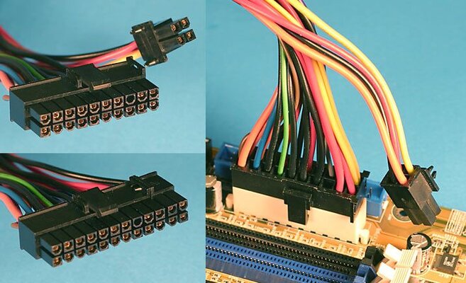

Hi,
I think the 24p connector, the one on top of the second photo you uploaded need to be split into 20p and 4p. Most 24p connectors should have a small clip that keeps the two parts together. If possible please upload photo from the other side of the 24p connector. Should look something like the photo I've attached.

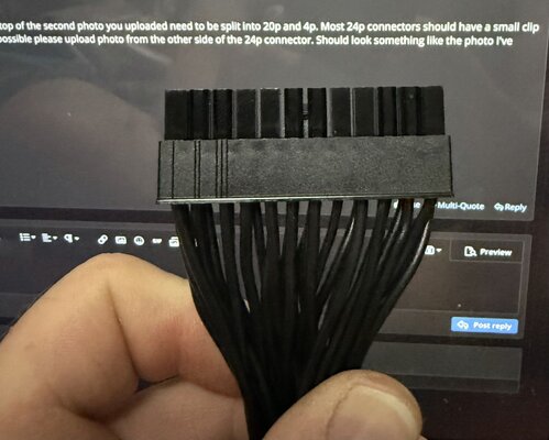

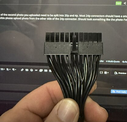

Thanks for the reply! Here you go….
Unfortunately it seems your connector cannot be split. Very common on newer PSUs. Most likely Corsair made a new revision and is now using newer connectors since the 20p is no longer used in motherboards nowdays.
