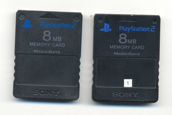

View of Genuine and fake card
Here is a comparison.
I've scanned a genuine Sony PS2 8MB card next to one of the new cards I've received from China. As you can see they are very similar.
PS. sorry about the dusts and hairs on the scans. I need to clean the scanner glass.

you know, those could be genuine too, the ps2 system is dirt cheap now (under 100eur here) it is logical they cut booklets/etc from memory cards and other accesorries to keep the cost down

That is why I was wondering if they really were fake or not as they look so close to the older genuine cards. But it is suspicious that the packaging says made in Japan, but the back of the cards say made in China.

They are fake Harrison I assure you, I spent days and days researching these, comparing them too and genuine 2000 - 2008+ cards are pretty much identical. Both feel the same too. If you got anything more then 8Mb that is "Sony" branded that will also be fake.

I think the best way to find out if fake or not is too open up the memory card and check for black blob silicon where the magicgate crypto chip normally should be..
But yeah one way to rule out any doubt would be to get Made In Japan but thats would be for very old 2nd hand memory cards..
