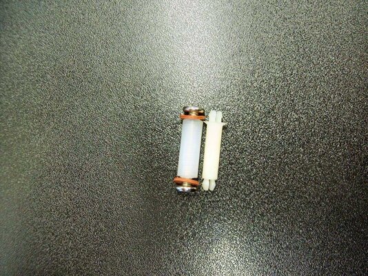

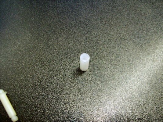

Would there be any interest in these if i were to get more produced?

I can help tipping you guys:
For poor people like me, there is a way to use DIY custom spacers.
How?
Well, you guys know I'm cheap, so...
First, take a BIC pen (just the outer case), cut it to the exact right length and put a long enough screw inside, put a suitable screw nut on the other side.
Done!:)

Nice idea, rkauer. Now that you mention it, one of my former co-workers used to take a stiff piece of pneumatic tubing (6mm or 1/4" thickwall) and make standoffs. As long as you didn't need them too long, they were very stable. You could even cut a thin piece to use as an insulating washer for top and bottom if all you had was metal fasteners.

OF course there are more "professional-looking" materials that a spacer can be made of, like Teflon, poly-amid PA6 (aka "soft" Nylon) and other heat-resistant plastics.
Even some are made from no-flammable wood (those are a bit cheaper than plastics, BTW).

to all of those wanting stand offs, please read trough this thread for some options.
now i can make these at work but there is a catch! we are flat out at the moment, so what i need is a list of interested parties and how many each person wants, when we get a little quieter i'll see what i can do, so how many stand offs are needed?
cheers, JuvUK
