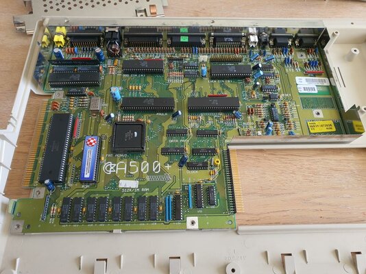

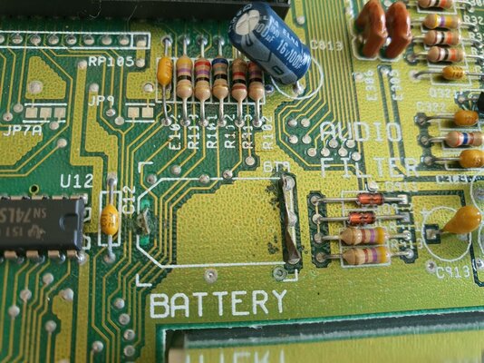

Hi Mate sorry to hear of your troubles, has the battery leaked in your A500+? this is very common and might need to go away to a professional to repaired, likly there will be some damage to sockets and traces around the battery area.
If you want to play just floppy based games go for a regular A500 as these didn't have leaky batteries and a build like a tank. nb. some memory upgrades came with a battery too so check those if you get a standard A500.
Thanks Steve :) I was worried about the battery as well, but after opening the machine I could see that the battery had been removed already. Furthermore it doesn't seem to have done a whole lot of damage. I have just put in a picture of the board and a closeup of the place where the battery used to be. There's a spot around one trace that seems to be darker, but I cant say if the damage is just superficial. amiga2.jpg

OK, (against my better judgement as I have ZERO free time for repairs), if you can get the machine to Brønshøj I'm willing to take a look for you to see what the issue is.
Unfortunately many 'newcomers' or as I call them 'oldcomers' underestimate how much care and work must go into keeping some of these old Amigas in service and kicking. In these cases it's better to buy a serviced and fully tested setup from a reputable source, but of course some are unwilling to pay extra for these systems and end up with lots of hair pulling. It's like buying an antique car and expecting it to run smooth and problem free judged by the look of the chassis. Please don't take this above personally, you are not alone by far with this experience, but unfortunately there is still not enough (good and reliable) information source on how to keep these older systems in shape.
