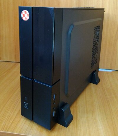

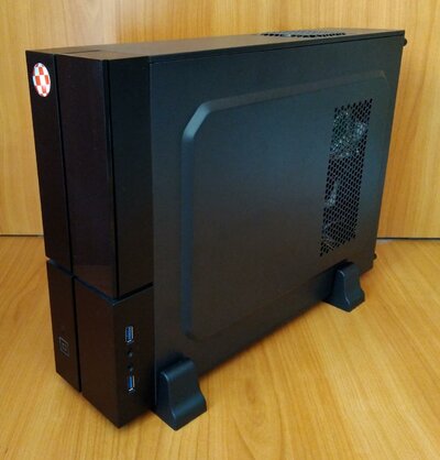

Major issue was the case. I snooped endless times around the Checkmate A1500 case but nonmatter how strong the attraction was, could newer get over the price (please do not get me wrong, I am not implying it's overpriced, it was just out of budget for me).
So, what to do? Well, a PC case has to do and here, I had a lot of constrains.
Case needs to look great (or at least OK), quality decent, needs to be small, should have a 3.5" or 5.25" drive bay (quite a challenge these days), not be too pricey and (did I mention?) look great ?
As a matter of fact and one month later, the victim has been identified: Aerocool's Playa Slim, around 45EUR, unfortunately black (try to find a white case today) but amazingly with a front panel that loosely resembles the Amiga 1000 original front panel.
View attachment 169301 View attachment 169302

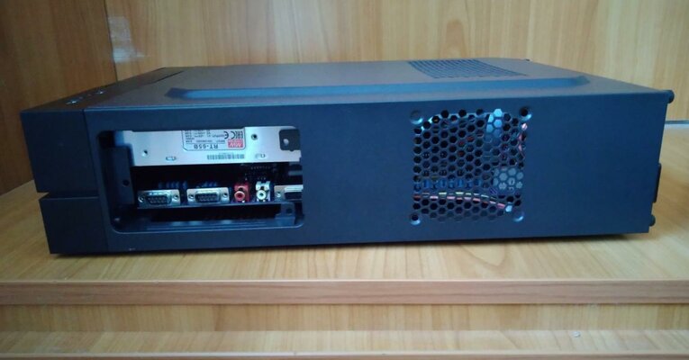

The Amiga motherboard fits and with a little bit of help sits stable within the case. The mouse, joystick and audio out ports match the exact opening for the PC power supply (not used). The other ports, I get to them later.
butt2.jpgView attachment 169304

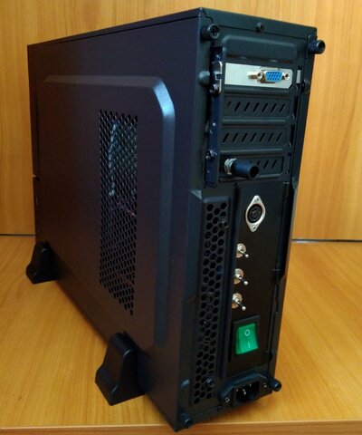

Having constrains caused by the PC case some connectors were skipped. Namely the serial and parallel port connector. All the components have been soldered except the connectors. Easiest option would be to solder some wires and mount connector in one free extension slot space. For me it was (is) no priority therefore not done.
Another unpopulated area is the analog video part. Having an Indivision ECS V2 installed which provides VGA video output directly from the Denise (which it also replaces), there is no need for the analog circuitry.

Power supply: needed something that can provide the required voltages namely +5 +12 -12 and amperage. Solution, simple, MeanWell RT65B used by many Amigans to replace the old PSU.

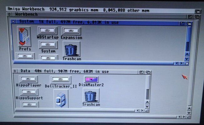

Now motherboard is prepared, power input connector replaced and adapted to accept wires from internal power supply, all passives soldered, components placed in sockets. All worked on first power on. Quickly loaded Battle Squadron for test.

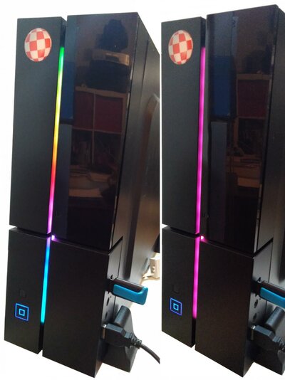

Although it was not my goal to have a colored LED bar on the frontpanel, it came standard with the case - totally useless but doesn't do any harm either. Fixed color or color cycling can be selected by a small button on front panel.

With the Gotek drive inside we need to bring out: USB port for Memorystick, some display, buttons or rotary encoder. Cutting case for LCD display was out of question so I wired the display signals to one of the USB ports on case.
The other USB port is for the stick. The rotary selector is mounted on back of the case.
The internal floppy drive is actually a HD 1.44MB PC drive that has been modded to function as an Amiga DD drive.
All selectable options have been wired to switches on back panel.
