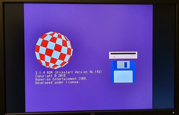

Before i start prodding the thing trying to figure out what's going on, I was wondering if anyone encountered something similar or has any ideas.
Maybe it's something simple or I did something wrong.
Config is A4000D, scandoubler alone on the daughterboard, not connected to CV3D, J1 and J2 jumpers are closed (actually behaves the same regardless of jumper settings if i remember correctly).
Anyway, I'm getting approx. left half of the picture stretched horizontally like on the pic (colors are fine, they're off on pic due to lighting or whatever). Tried on multiple monitors, same thing.

On multiple pics of the card here and on other sites I've seen that DAC's _BLANK pin is tied high via a patch wire, suspecting it could have been a post manufacturing fix of a sort but on my card this also appears to be in order.

Thanks for the help guys, got it working now.
In completely unexciting turn of events, error came down to the lousy connector on the daughter board.
