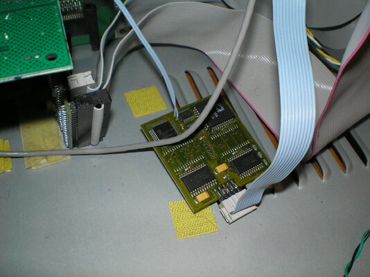

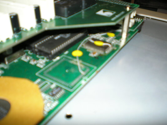

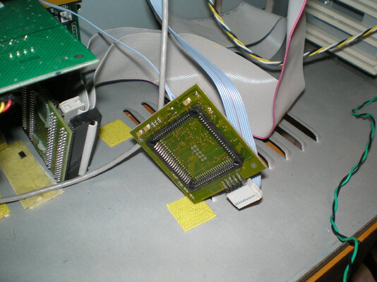

ummm whats the sqaure thing and where should it go?

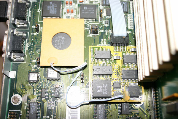

so i have a scan doubler? so what's this?

that's a part of the scandoubler, it clips on the ALICE chip, the cable should be pointing toward the other part.

okay how to fit a scan doubler/flicker fixer
Here is pic by Doppie1200 from Amiga.org
shold help you with facing and alignment :D
now that othe set of wires looks like some interesting bit of hackery involving the ec020 and the never populated FPU port..
if you could take the mediator off and get a closer lookie with the camera (in focus) i may well be able to have a stab as to what the mod is trying to do. :D

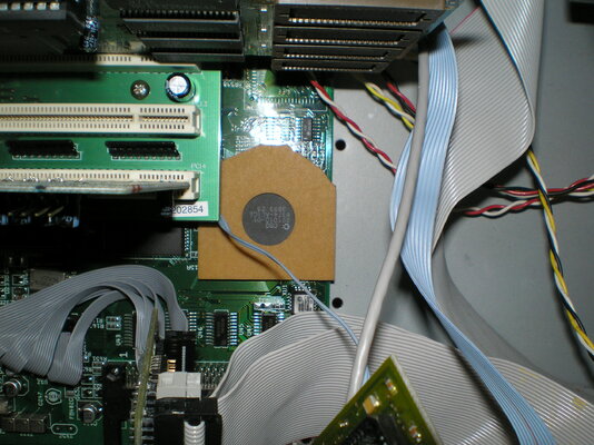

i shall try and get a better pic for you Zetr0 m8, now i've put the square thingy back on Lisa, i'm guessing i should now use the vga out from that thing to connect to my monitor? because i'm just getting no signal?

lol, yes VGA out (15pin HD) to your SVGA monitor :D

nope there should be a VGA header from the Scandoubler, this is what you need to plug-into the SVGA monitor :D

so what does the graphics card do?

actually you need a monitor switcher. you have two outputs from your amiga, native graphics output, (from scandoubler) and graphics card output. Now if you're only using workbench and friendly programs, you can do without the native graphics output, and live with the graphics card. however, anything that uses the graphics chipset (read, all games, demos, etc) will switch to native graphics output, you can't view from the graphics card. that's the sad state of affairs with graphics cards and amigas unfortunately. graphic cards which plug into actual zorro slots (and video slots) of big box amigas may have built in monitor switchers though (CV64, Picasso IV comes to mind).
Also, when you're making your first installation, you will need the native output until you setup your workbench and configure your graphics card.

In your first post, the Bottom Pic shows another couple of possible Chip locations on the board. If they were populated, it would be a Flicker Fixer as well as a Scan Doubler! :wink:
