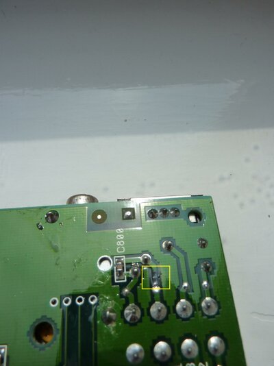

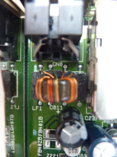

Right I have taken some pictures. As you can see this is still a clean and tidy board. The only thing is highlighted in the yellow square on the underneath of the board.
The power supply is being returned to be checked from where I purchased it from so I hopefully will have an answer from them as to its condition, though I know its not right due to the sparking sound it sometimes makes when turned on & sometimes it just does not turn on at all.

From the second picture I can tell something sucked way too much current from the power supply.
A near-death HD or short-circuited CF may do this kind of problem. Check the IDE header area for burning signals.
The PSU socket trace can be repaired by a simple jumper wire (remember to use a thick wire for this!).

in you 2nd image (the underneath of the motherboard.. just past LF1 the 5volts has gone directly to ground - this has burnt out a track on the motherboard. The clicking you hear is small electrical discharges making contact with ground.
As rkauer has stated you can bridge the 5V output of the LF1 to the C800 capacitor (0.01UF) I would also suggest replacing this SMD 805 mono ceramic 805 capacitor as well.

Thanks all for your help. I have managed to fix this by soldering a wire over the damaged area and cutting the track!
Who would have thought that it was that easy! First for me that and I am chuffed to bits :lol:
The solder gods were smiling on me this day :bowdown:

Now, on a serious note, did you change the Capacitor? I wonder because thats a cause of concern, after all there was enough current to use a rather large bit of copper as a fuse wire!
Well Thank you Mr Zetro
It was the first time I have ever used a soldering iron so I only soldered a nice thick wire underneath and then tested it for an hour... so not replaced anything else
