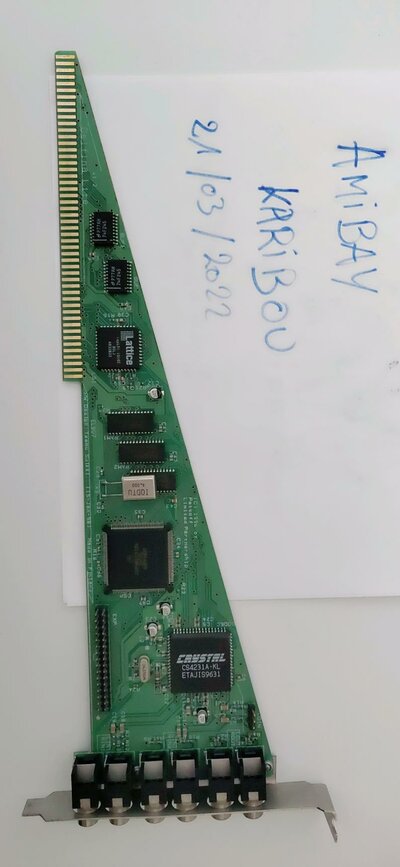

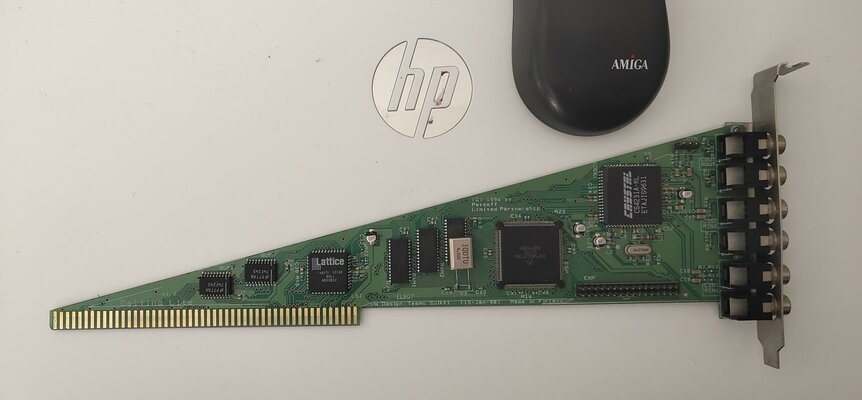

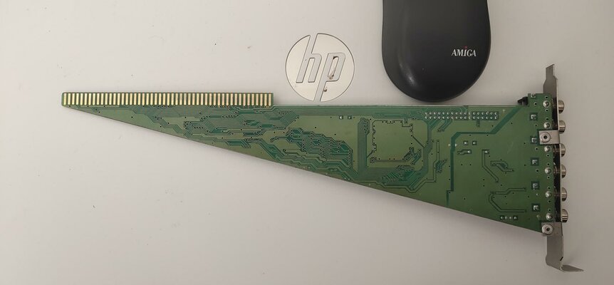

For sale :
Delfina Lite DSP soundcard.

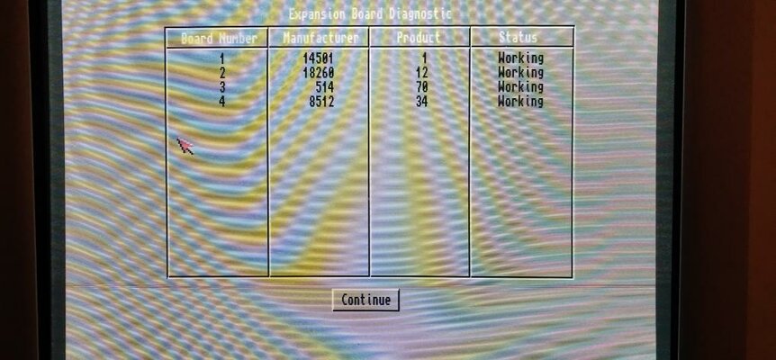

Stated in early startup as working.
Was working 20 years ago under 3.1 and 3.9 . I never managed to load the drivers under 3.1.4 or 3.2...
Asking 200 euros + shipping

Declaring interest. Is there na option to send it back if it turns out, card does not work under 3.0/3.1 AmigaOS?
I have Delfina Lite. It is working under OS3.1. Not easy (in any case), but working well.
"sax you were correct the first time you would of been after Hannibal"
I don't understand how that is. :-(
Stated in early startup as working. But freezing system after delfmem or delfinit. Tested on 4 different amigas with different kickstarts and different zorro busboards. And with 3 different versions of delfina.library. Looks like memory on the card is faulty...
Not sure! Only one library version working fine on A4000. (delflib416b43)
I have tested it on A4000, A2000 and two A1200 with busboard ZIV. I have tried the following versions of delfina.library: 4.16B27, 4.17B1 (my delfina flipper works with that one) and 4.17B392. Now I found another one, 4.16B48. But I don't have 4.16B43 you are talking about. I have to look for it.
From matt3k's setup guide:
https://www.amibay.com/attachment.ph...7&d=1514823760
It's been a while, but I do recall that attempting to initialize the Lite using any newer library intended for the Flipper would hang the system.
It doesn’t work with anything newer than Petsoff releases and even then, the watchdog task often crashes on the Lite version.
I have tested it again on A4000 with delfina.library versions: 4.16B43, 4.16B48 and 4.16B3. Still the same, freezing system after delfinit. I will do the same on A1200 with zorro busboard on evening.
