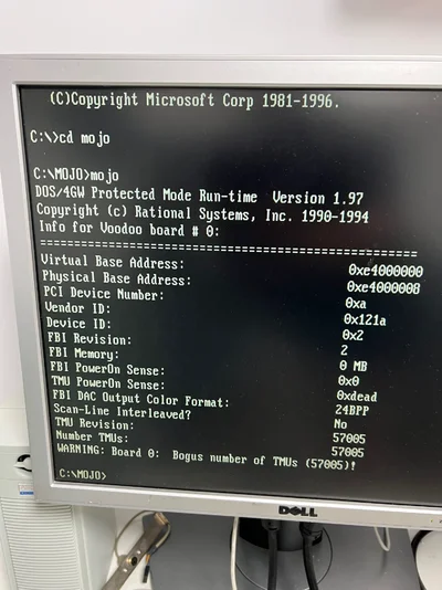

Reflowed FBI and TMU chips. Checked for loose pins and bridges.
All 3 chips get warm when card is powered.
Card boots into windows, get detected, no glide error at windows startup. System hangs when accessing voodoo tab in windows or trying to start a 3D game. Mojo report in attached image.
Clock generation is ok. Checked all resistors. Checked ferrite beads. All seems fine.
I'm giving up. Hoping someone does a better job than me. Probably a broken trace somewhere that i can't find. Overall condition is very good.
