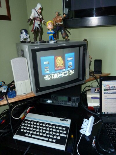

Bas upgraded my Oric 1 with the ATMOS ROM and I can get it working 100% using tap2wav converting the TAP file to 11Khz WAV files and playing it back via Windows Media Player with the volume set to 80% on my old XP laptop.
