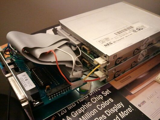

I found this on e-bait and couldn't turn it down; seemed to have been overlooked by others so I managed to grab it - one of the drive covers was cracked and didn't hold in place but no worries as my A4000 appears to be the only other one that even has a drive flap anyways :)
attachment.php
I tried it out by booting my A500 that has a finicky internal drive and noticed that only the top unit appeared to be working.. Time to open it up :)

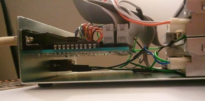

What I found was a nice slim pair of HD floppy drives! A bit more looking revealed the reason the second drive didn't work:
attachment.php

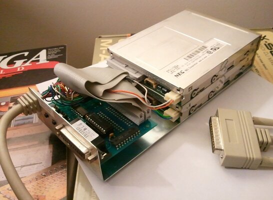

It would appear it had a separate power supply that connected to an external power jack.. After a bit of searching I found that many folks had no problem running 2 external floppies powered from the disk port so I made a quick Y-adapter and tied it onto the existing power leads:
attachment.php
Back to the A500 and I was able to boot from one and run software from the other no problem -- bonus is that they're extremely quiet and seem to be fairly quick.
