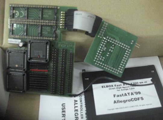

Elbox FastATA 1200 MK-III
Connect ΑΤΑ-IDE devices up to 16.6 ΜΒ/s…
Hard drives, CD-ROMs, ZIP drives, etc.
The card is boxed, as new, along with drivers and manual.
* An Amiga 1200 with 4MB RAM is required
http://www.elbox.com/products/fast_ata_1200_mk3.html
Item located in Athens, Greece. Payment with Paypal.
Price: 80 Euros
THANK YOU!!!!!

After many tests FastATA does not work with any of my two 030 turbo card, I also contacted the Elbox unfortunately they can not help me.

Hi
I have ACA 1232 and E-matrix Both cards work great with MKIV but not with MKIII (flashing LEDs yellow screen and reboot)
tested on two motherboards rev 2b and 1d1
