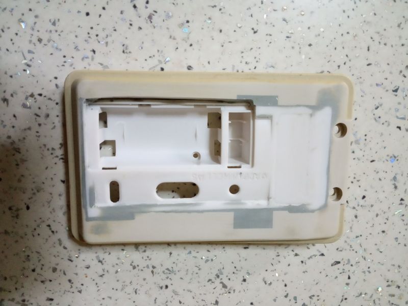

This is a project i started years ago, but only now did i recall in my mind. I wanted to mod a regular tank mouse for wireless USB, so i can have that retro feeling on my UAE platform. I can of course finish this prototype for myself, but was thinking if enough people are interested, i can make molds. Estimated cost would be hopefully around 40-45 Euros, but volume matters. Here's a pic of the prototype's bottom part:
So, what do you folks think?

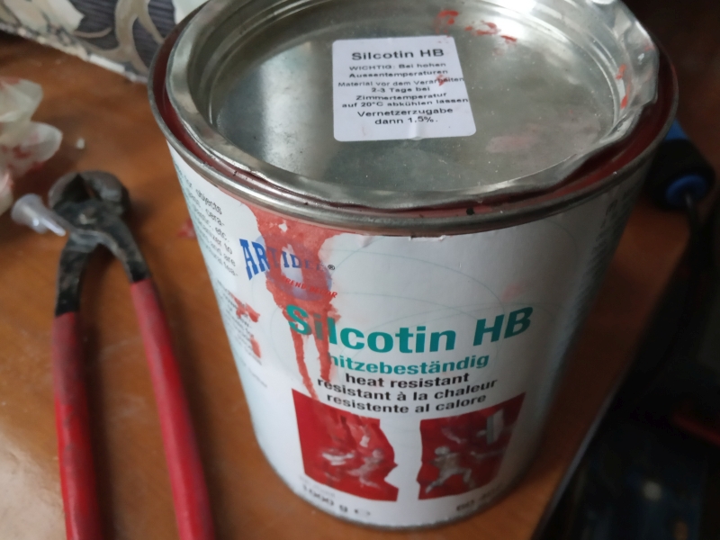

Real life is always in the way, but anyhow, i decided to proceed with the mold, regardless public demand. Once finished, i'll be sharing this with a few friends. Anyway, long story short, here's todays' pictures:
That's the release spray, used on the surfaces for easy separation after the silicon has cured (dried).
That's the mold silicone, expensive, but very good quality stuff. After many experiments, i wouldn't change it with anything else.
And here's the mold, with silicone left to cure. Tomorrow we'll see if things went as expected. :-)
