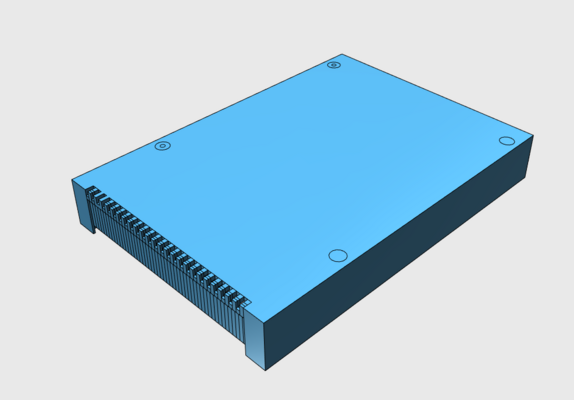

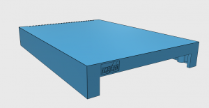

Couple of weeks ago I started designing an enclosure for a 3,5" floppy drive that would make it a proper external drive. I use external floppy drives with my Amstrad CPC6128, Spectrum +3 and BBC Master.
Here are a couple of pics of the first versions of the case.
Case_bottom_final_front.PNG_thumb.png Case_top_back.PNG Case_front_amstrad.PNG_thumb.png Case_front_acorn.PNG

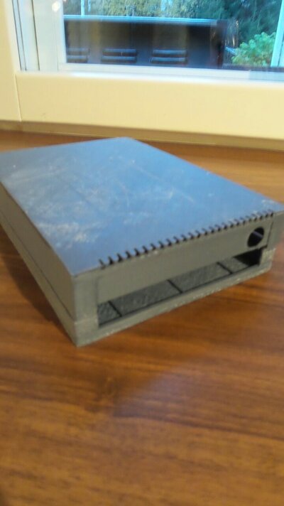

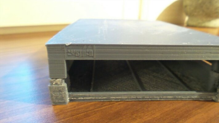

Yesterday I got a couple of pictures from a friend of mine who has access to a 3D printer. This is the first version.
altAv8giQ6fLVvcbbTHyQd8hai6ptE7l3XF0hrAJm-cuvsp.jpg Edited_ImageEasyImageEditor_20141007_68.jpg
As a printed piece this is quite large, which causes its own challenges to the material. ABS has a tendency to warp with such a big piece. Therefore HIPS was chosen as the print material for the item in pictures.
I've actually tweaked the model based on the results. One of them is to make the logo an empty space onto which the actual logo will be printed with a finer pitched nozzle to make it more accurate. The other was to leave more room for overlapping parts.

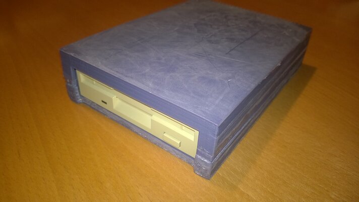

I tried a floppy drive inside the case. Fit's almost perfectly. The upper case needed some tweaking, which I've done into the model. The case will have an appointment with Dr. X-acto. Have to find a suitable plastic filler to smoothen the sides of the case and then paint the whole thing.
I also bought a thread tapping tool to make screw threads into the upper half.
I read about that myself. Unfortunately in this case there were some complications in the printing process that caused imperfections that can't simply be corrected with acetone vapor bath. On the other hand I don't know how HIPS reacts with acetone.
