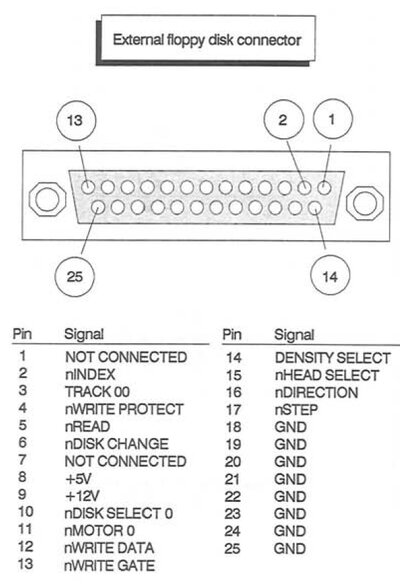

Hello all:
I have been trying to find an external floppy drive that is compatible with 25-pin connection on the back of the Vortex Golden Gate emulator. I have the 82077AA chip installed, but two drives that I have tried did not work (one was a 25-pin parallel interface).
Anyone have success with this setup? I want to keep the internal drives devoted to the amiga.
Thanks!
Chris
- - - Updated - - -
Just FYI, this is the 25 pin connector pinout, as described in the golden gate manual:
Thanks for any suggestions!
C
