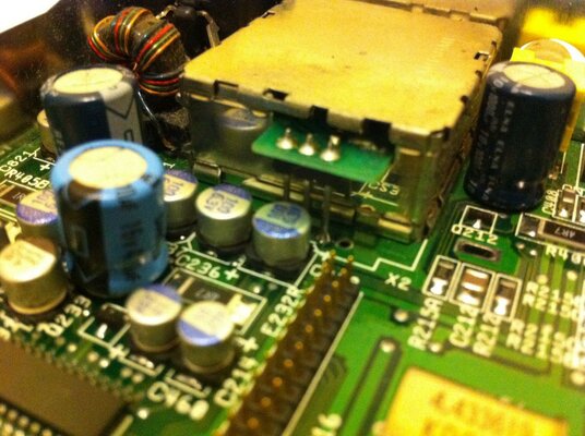

So I separated out the motherboard...I have it in my hand as I type. I can see a few capacitors near top left and few others. I'm not 100% sure what EXACTLY and WHERE exactly I'm looking for it. Are there any images/diagrams that anyone's aware of. Worst cast, I'll upload a pic of mine.
Checked to make sure ROM is seated..looks good. What are solder pads?
I'm thinking my ability to do this might be lacking. I just read somewhere that it's not just what I thought we're capacitors...(colourful tall towers) but also something called surface mount capacitors...shiney silver ones which I won't be able to solder with a iron I got knocking around a draw. I'm going to have a good look around them all now. Thanks guys
The shiny metal blobs on surrounding components. Is where the solder goes to connect the devices to the board traces.

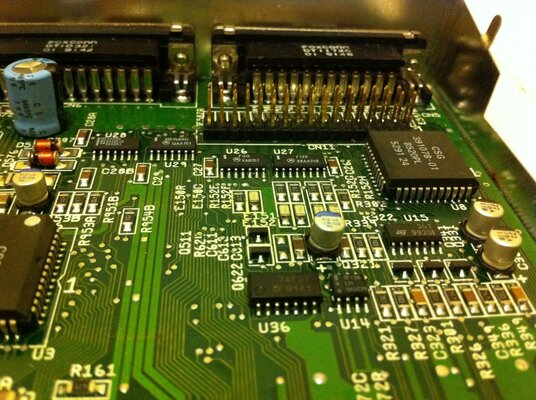

Right folks, I had to get a magnification glass out. I *think* there the solder pads are a little duller than other shiney silver pads. I've added a bunch of pics. Sorry my cameras not the best.
Any opinions folks?

it is tough to tell from those piccies, but there look like a few suspect ones in the 1st pic, the ones near the power/video modulator section
