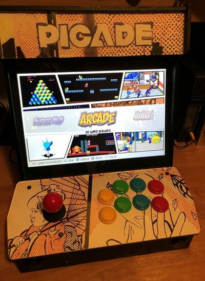

I was lucky enough about a year ago to get a PICADE (Kickstarter Edition) so this is the 12" screen which fills the bezel with 8 Player, 2 front & 2 side buttons.
it was wired up incorrectly, 12v to audio out for example.
needles to say, the monitor driver board was damaged, working of sorts but had to be replaced.
i didnt like the 2 PSU options, 1 for the PI and 1 for the screen, it was messy,
I didnt like simply unplugging it from the wall to power off and a chance of corrupting the SD card.
so......
I replaced the 12v1amp Monitor PSU with a 2.5a model.
I replaced the PI 1 with a PI 3 so it sits nicely on the local network very easy to add/remove games and for the increased performance.
I looked at the monitor driver board schematics I purchased and discovered (If you buy the correct version which i was lucky and had done) a 12v DC to 5v DC regulator is fitted and gives a good 2amp output.

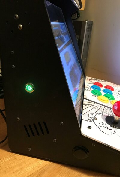

I searched for a way to power off the PI via a button and got myself a ATXRaspi, a cool little gadget to Power ON/OFF/Sleep/Reboot the PI via an illuminated push button. :D works a treat wired in to the monitor driver PCB.

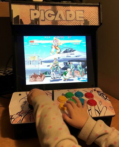

so im very happy with the result and have a really nice setup Retropie, I added a script to play Background music in the main menu.
The kids love it.. and it's a lot less space than my jamma cab used to take.
the only addition i need to do,,,, add a USB port on the side or rear for a 2nd USB controller for 2 players,,, or use the inbuilt Bluetooth (depending on lag) for a wireless controller..

Looks way cool dude! You've done an excellent job there. My guess is that the ATXRaspi thingie would need some sorta script to work properly though. I was trying to find a way to do a proper shutdown, but it looks like they all need scripting. Dunno much, but i figure depending on the host OS, these scripts might/might not work. For example, what would happen under Amiberry? It's on top of a DietPi OS, and i'm not so sure it will work. If you care to look at my late Pi project (another Winter new project), you'll see that i installed a PowerPack with a 3800mAh battery. I'd really love to have an easy way of shutting down without corrupting my SD card..
