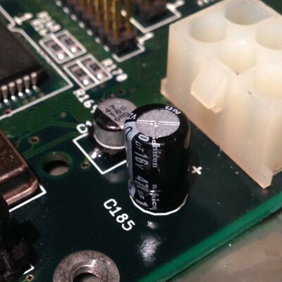

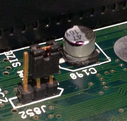

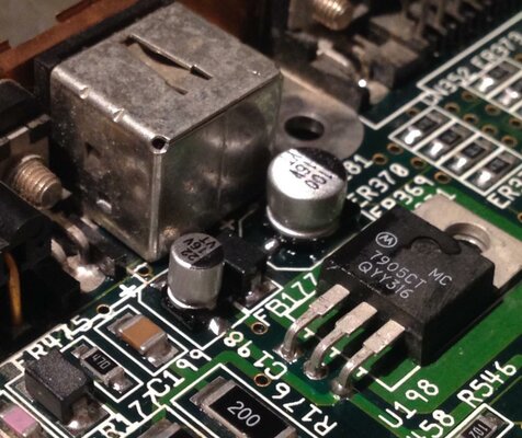

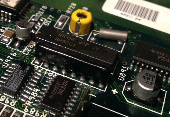

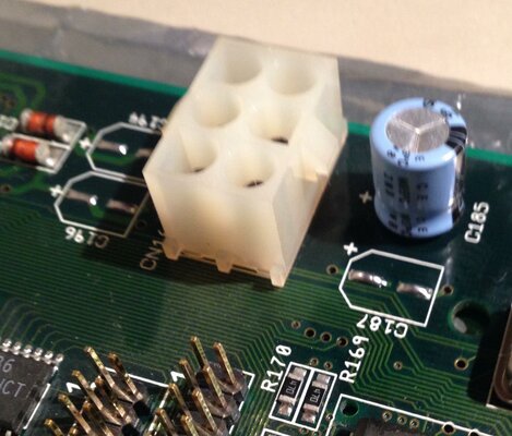

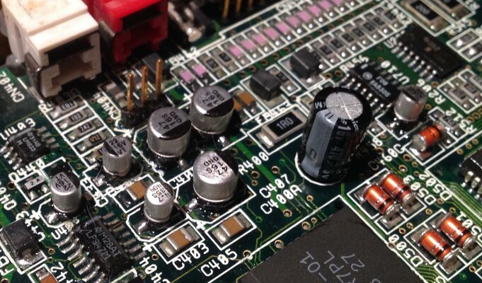

A few days ago I was more than confident that I was ready to tackle the A4000; upon opening the case for the first time in a few years it was quickly evident that nearly every cap had leaked -- in particular all the 47uf caps were sitting in a pool of their own electrolytes; so I quickly swabbed everything up with alcohol and prepared to extract them all.
Here's a few pre-removal inspection shots:
01-Old_Audio_47uf.jpg 02-Old_Battery_47uf.jpg 04-Old_Slot_47uf.jpg 06-Old_KB_100uf_22uf.jpg

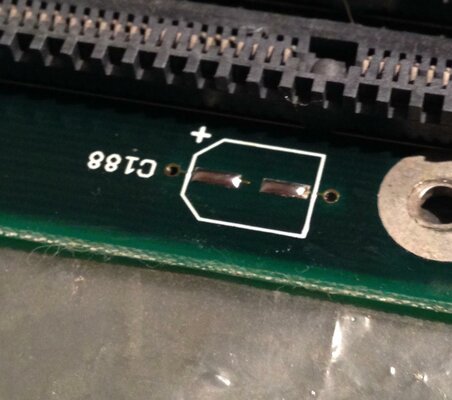

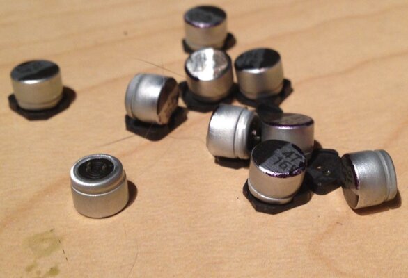

The removal technique I found the most effective but time-consuming (though somewhat therapeutic) was to apply gentle pressure and rock the cap back and forth until it loosens a bit then start rocking in alternating circular motion and after awhile it will fall off without much fuss. The through-hole caps can be removed in a similar fashion though just rocking them back and forth is usually enough. After that I hit them with flux, re-flow some solder to remove the old capacitor legs then clean them up and re-flow some new solder to the pads:

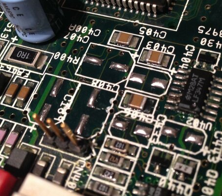

01-47uf_Removed.jpg 02-C188_Clean.jpg 03-C187_C196_C194_Clean.jpg 05-Audio_Clean.jpg 11-Audio_TH_Clean.jpg
Up next; with the board all clean it's time to replace the caps.

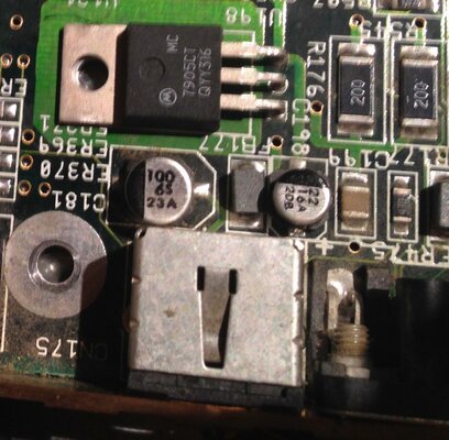

I used an USB pen-sized 8W iron with a very fine tip and super-fast heat-up and cool-down time (10-15s) which makes it easy to stop and start as I go. It can be easily found in a review on Big Clive's YouTube channel.

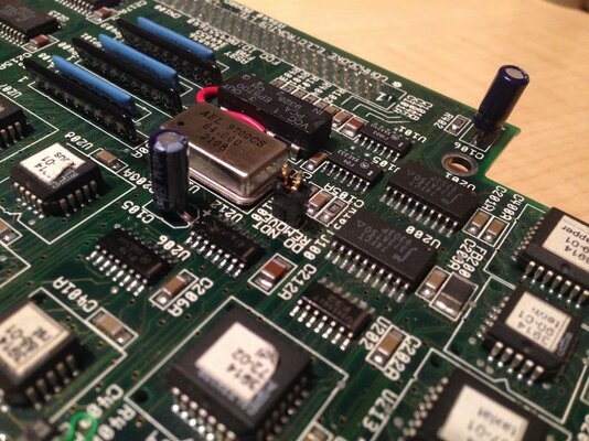

The caps were placed by first heavily fluxing the area then carefully floating the caps in the flux aligned over the tinned pads; then one pad is heated and after a moment the cap gets pulled down to the board and soldered into place; minor alignment for the other side can then be made by be re-flowing it and adjusting the position. Then I apply a gentle pressure to the top of the cap and solder the other side; then if needed re-flow both sides a couple times applying gentle pressure until it lies flat on the board.
Some shots of the finished caps:
18-AudioAndTH_Replaced.jpg 16-KB_Video_100uf_22uf_Replaced.jpg 14-Para_22uf_Replaced.jpg 15-PowerTH_Replaced.jpg 17-C200_C192_Replaced.jpg

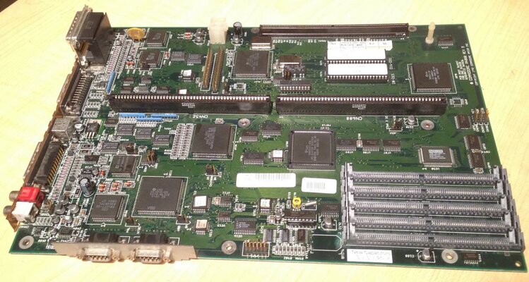

And an overview of the completed board:
And with that it was time to put it back in and give it a go...

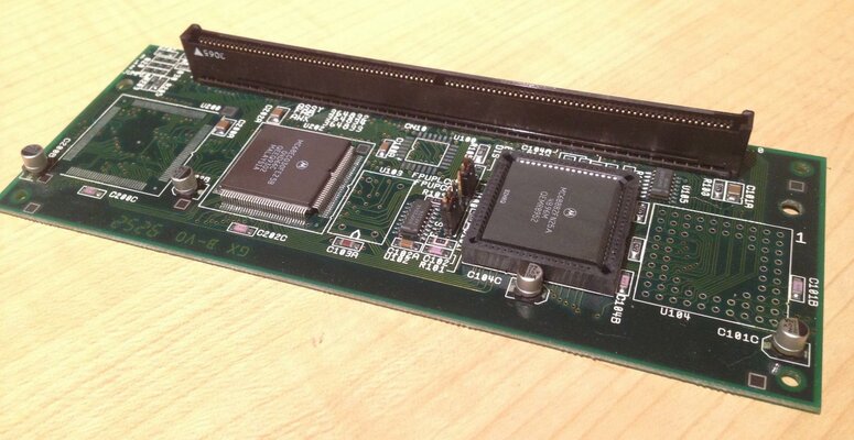

Eagerly installing the '040 card I would get a boot screen and could get AmigaDOS but it would crash after a few moments every time. I was able to put in the '030 card and then it was able to boot and run a few tests to confirm that everything seemed functional.

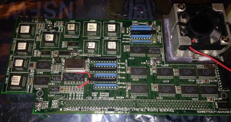

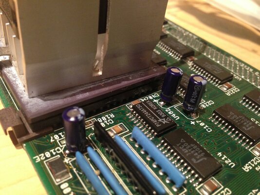

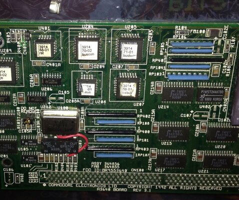

With that I began inspection of the '040 CPU card and found many blue corroded leads on the caps; and after triple-checking online I found that some caps were originally installed backwards as many A3640 cards were..
Next up; replacing the A3640 caps!
Replacing the A3640 caps

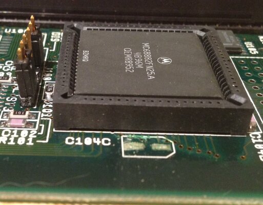

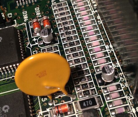

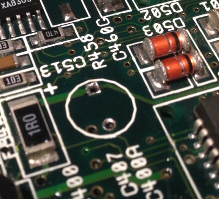

First up was to remove all the old caps from the board, the C102's, U220 and U402 had the worst corrision:

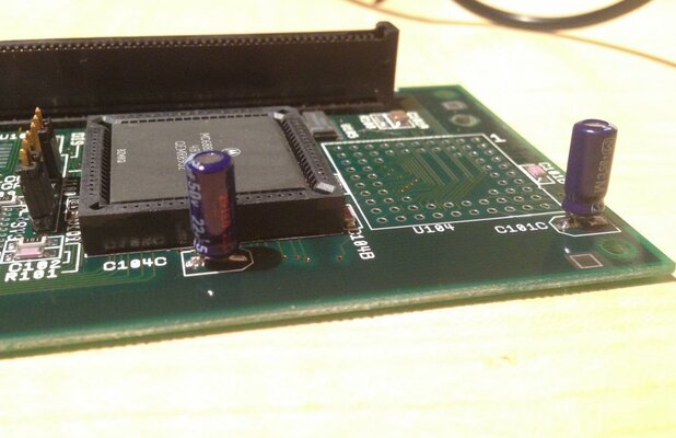

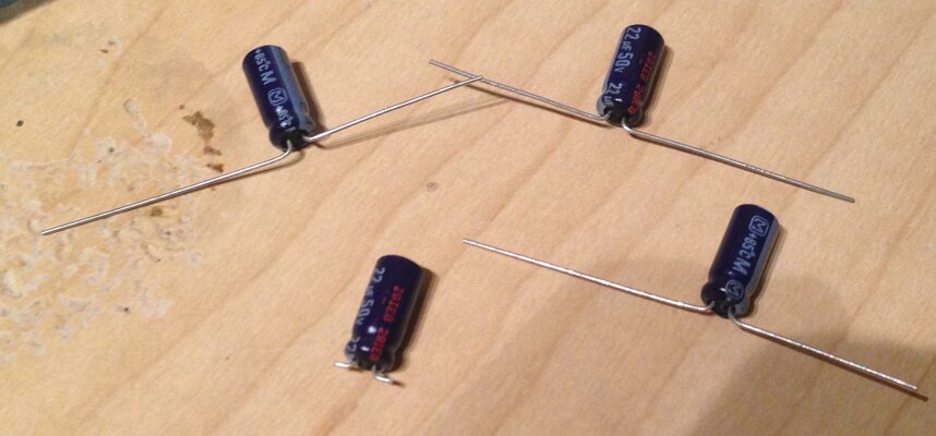

After that I cleaned up the pads same as the A4000 board and prepared the caps -- My order of new SMD caps for the '040 board will take a few weeks unless I wanted to spend a lot; so in the meantime I stopped by the local shop and got through-hole caps of the same value and radius (though taller) for testing and prepared them for installation:
Installing them was as simple as using a dab of flux on the tinned pads, holding them in place and soldering one side then the other; the leads have much more play so reflow isn't even necessary for minor alignment changes:

But after removing the caps the leakage was very evident; and luckily none of the VIAs had corroded:

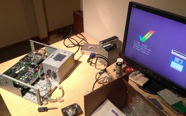

And with that finished I re-installed and tested the '030 card which appeared to be working ok; and then quickly moved on to the '040 card.
It's alive! And stable! Rocking the relic demo by nerve axis in the photo; it's bit of a slideshow still with an '040 but working fine otherwise. I tried out a few more demos and applications for about an hour and all appears well.

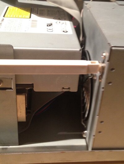

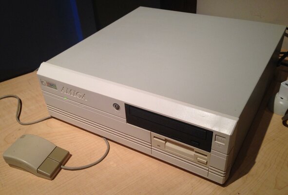

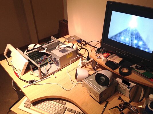

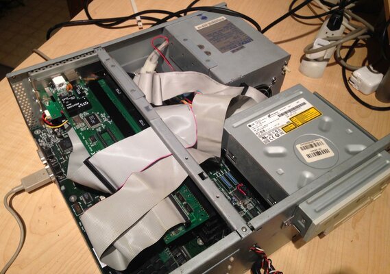

With everything in seemingly working order I eagerly re-assembled everything and connected the DVD drive which I'd installed years ago but never set up due to the audio failure.
And.. no boot, no drive light, just black screen :(
I disconnected the DVD drive and tried again; but nothing, no drive light, black screen.. After a few attempts to start up I finally let it sit while googling possibilities and it suddenly arrived at the desktop.. A quick review of the schematics and I traced that the IDE_LED signal is actually provided by the drive over pin 39 on the cable -- aha! Replacing the IDE cable with a new one and the drive light works again.. PHEW..
Unfortunately after an hour of fiddling with the DVD drive it just won't respond; and putting in a disc makes an odd squealing noise so I sacrifice another drive from an external enclosure which unfortunately doesn't match the color but does work:
It is a tad bigger than the previous drive though so it was a bit of a tight fit:
Finally I cleaned it up a bit with a magic eraser and closed up the case.

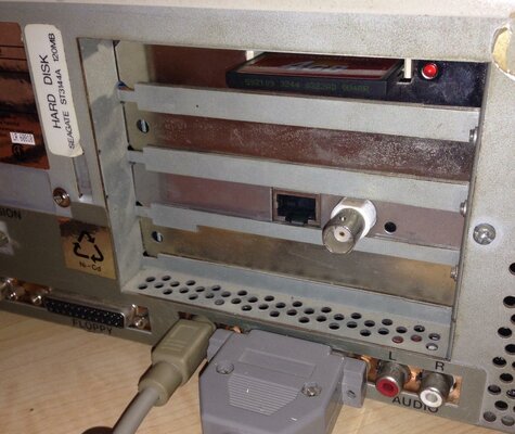

Rear shot of the 4GB CF and X-Surf:

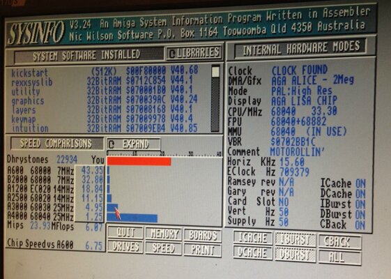

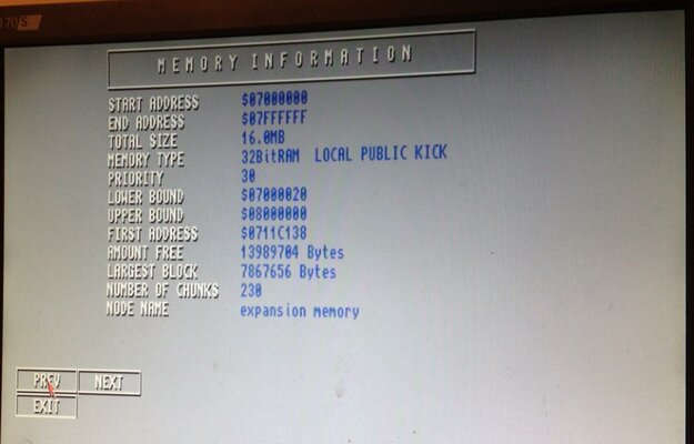

And obligatory SysInfo screencaps :)
So relieved to have this baby up and running again!

Good call as the caps in the audio area have leaked and corroded your board already, was just a question of time before your audio go faulty by base eating through the copper traces.
-1 for removing them by mechanical force, you might have gotten away with it, but I've seen dozens of boards with missing SMD pads- pulled of with the old caps - difficult to repair well afterwards.
and sorry also -1 for not using the correct capacitors on the CPU cards, since they are exposed it takes all but a quick bump (when installing Zorro cards etc.. and again the SMD pad will be gone, at least you didn't hot glue the wrong parts to the board (;-)) if this is really your childhood gear, then I advise you to give it enough respect to get the correct parts and re-do the CPU cards.. :)
I'm even ready to send you the correct caps for free (just pay postage) just PLEASE don't have through hole parts on SMD boards... :-)
Aye; I'm very happy that I cleaned up the audio area years ago before shelving it; it hadn't gotten any worse since then and the new leaks all looked very wet and recent -- cleaned it up before inspection photos but you can see some green ooze on the desk from the removed caps.
I was really hesitant to do it myself but I was extremely gentle and had practiced dozens of times on non-amiga dead/donor boards I picked up from scrap -- it took several minutes per capacitor with tiny wiggles which loosen very gradually. I've seen several videos on youtube of crushing them with plyers and twisting which made me cringe worse than watching a fingernail torture scene :o. Possibly over the next couple years I'd like to get into doing hot air work but haven't got a proper work area and practice for it yet. I'm hoping to do my A1200 board later this year and am likely going to end up using ChipQuik on it instead.
The offer is much appreciated and I realize I wasn't very clear about why I used the through-hole caps on the card -- I've already ordered a pack of proper Nichicon SMD replacements but they won't arrive in the post for several weeks; I picked the others up as a temporary solution to see if it was functional (or if I needed to order more parts) and intended to replace them when the new ones arrive -- I don't plan on transporting or doing any more disassembly in the meantime unless very carefully.
Probably ChipQuik is the best idea doing this "on the cheap", but even just adding normal solder to the joints (as much as they can take up) and using tons of flux will do it too (heating the joints while alternating between them). Key is to push the capacitor sideways (never pull) once the solder is melted, getting both leads away from the pads at the same time. Mind you this would only work with non-corroded joints, corroded joints are notoriously difficult to heat with an iron due to poor thermal conductivity - best bet in this case is hot air (heating the whole cap inclusive joints).
All right then :thumbsup:, just wanted to point this out - I see way too many "hacks" with incorrect caps used - yes it will function - time proof? Nope for the already stated reasons..
