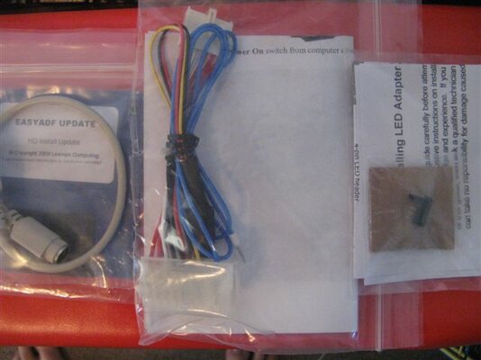

Well since I don't have all the bits I can't start the build yet but hopefully when my 2nd order of bits from Amigakit arrives probably early next week I'll be able to make a start :ninja:
Here's what I have so far:
EZ Z4 Tower from Amigakt
ATX-Amiga power adapter
LED Adapter for Case
AT-PS2 Mouse adapter
A1200 Mobo - 3.1 Roms
PC Key Keyboard adapter
40GB HDD with CWB ADV SP installed
SCSI CD Rom
New & Shiny FDD
Micronik Z3i Busboard & Video Adapter
Typhoon MK2 030 @ 40mhz & 64mb + SCSI
SCSI & IDE Cables
Still waiting delivery for:
Cybervision 64/3D
A2000 Keyboard
ATX-Micronik Power Adapter (Amigakit are maikng up)
Netgear MA401 PCMCIA card
Here are some pics of what I have so far! I'll update along the way with progress (y)
Steve.

Here's some more pics:
Got CD & Floppy working fine as you can see from the workbench shot (y)
Must have done something wrong with the LED's as they are not working :Doh: *fixed they were plugged in the wrong way round*
Just have to wait for the CV64/3D to arrive and for a power adapter for the Micronik Z3i before I can move on. Also once the CV64 is in I'll probably want to upgrade the CPU, 040/060 depending on budget.
Anyway, back to the Pr0n...
Mobo Installed, nice tight/secure fit - Good Job on the case design Amigakit (y)
CDRom wired up although I had to remove the PSU later make some changes to the ID + I plugged in the SCSI cable the wrong way round to start (oops) Lucky nothing go fried :roll:
Here's how I setup the LED's, what did I do wrong? *fixed they were plugged in the wrong way round*
PC-Key 1200, working well with a basic PS2 keyboard, just waiting for an A2000 Keyboard to arrive for more a more authentic Amiga experience :D
All setup - Good to go, now for that first power on... Doh black screen, hmm... Unpluged the Accelerator and she fired up so I checked the SCSI cable and yep, was fooled by how the previous cable I had plugged in and plugged it in the wrong way round, once corrected she fired up fine with the Typhoon (y)
All up and running (y)
CD & Floppy working fine (once I worked out how to change the device ID jumper settings hence the PSU comming out)
Played a game from CD and some WHDload, seems ok.
Now to fiddle with the OS and sort out Large HDD support.
Steve. :ninja:
