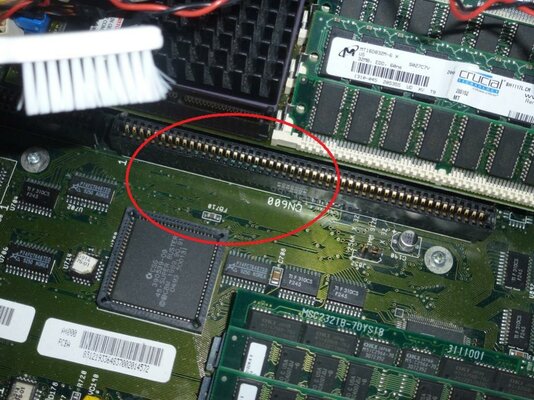

Well I came back to it to fiddle with the screen modes/settings and not booting again :Doh:
After stripping down and cleaning all connector with IPA, left to dry and re building still not booting. Connector is fully straight and inserted so I'm at a loss, very reluctant to try with my CSPPC in case I damage it and I want to use the CSPPC in my Mirage Pro Tower anyway..
CSMkIII still boots fine without the GREX attached by the way.
Unless it's worth trying another A4000 Motherboard, this one has always been a little flaky with Zorro boards, oh and come to think of it, it's Buster-9 :dry:
Hmmm....
Might be another late night mate... have a Beer...
I just noticed when looking at my pics, the camera flash picked it up! Some corrosion from previous repaired battery leakage that went missed!
I've just cracked open the Lemon juice :lol:
All the green is now gone, will clean it shortly with IPA but no more tests until tomorrow :coffee:
