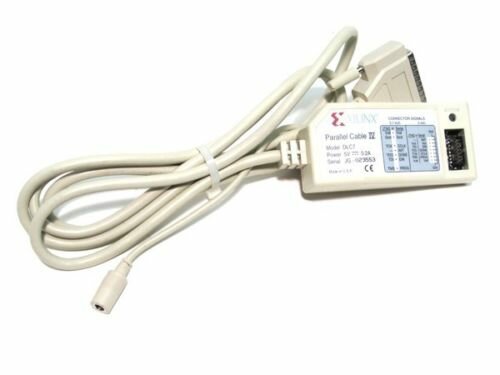

I chose to program the Xilinx chips onboard using JTAG. JTAG provides a handy way to reprogram the chips if needed. No need to desolder the chips, reprogram them and solder back.
Here is the JTAG pinout and the JTAG programmer connected to the turbocard.
