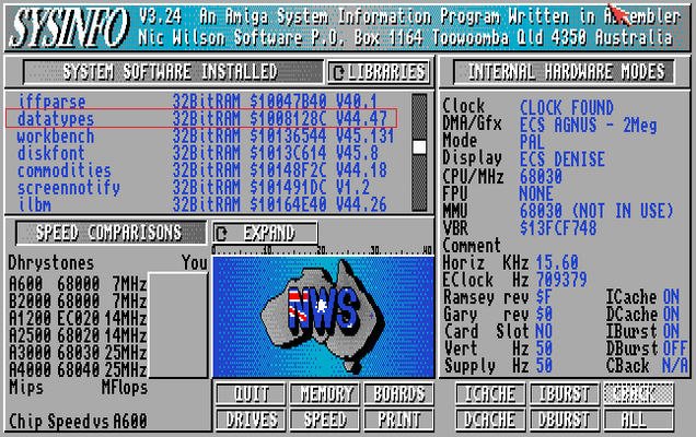

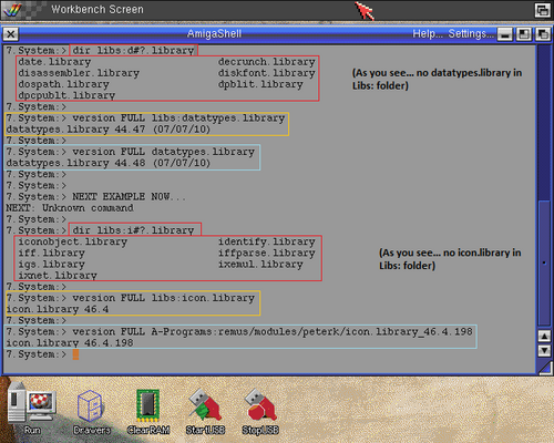

Hey guys I had a question for some time now that I can't answer with my little knowledge on the OS
First of all, you all know I have a custom ROM with lotsa shit in in.
In the ROM I've also included datatypes.library version 44.48 (while the old one was 44.47). I also renamed the old datatypes.library from Libs: just to be sure that the correct library is being loaded from the ROM.
- When I boot with the custom ROM, I check from CLI the version and correctly the version outputs 44.48 (which is the one I inserted to the ROM).
So far so good.
- As I said under Libs: there's no datatypes.library (as I renamed it) but typing version libs:datatypes.library ouputs me a 44.47!!! OK... WTF? where did that came from?
Check the following screenshots including version outputs and the output from SysInfo...
All other libraries and stuff in the ROM output just fine but had question about that (althougt it shows the correct version in CLI).
