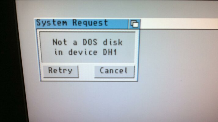

bah !
Been at it for about 6 months now. (Working WB 3.1/ 3.5/ 3.9/ CWBgaa 3.0/ 3.1/3.9...ffs and sfs.
Using Sandisk Ultra 30MB/s 4Gb/4Gb/8Gb and Kingston 133x 4Gb
-a1200
-a600

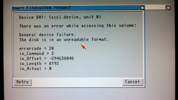

I can do it all right with ffs and get a working WB3.1 for a few hours/days, or CWB3.1 on sfs(not working at all)...of course working fine in UAE.
This is the closest I have ever gotten: ( as I understand that nothing less than SFS is worth zip in regards to CF? )
My blizz is dead, so I only got 2 megs of chip to play with.
...incoming 44-way cables from AK.com...gonna try an old Conner 2.5". If that works...well...I might stick with ide for a while....can feel the years beeing stripped off my life by torturing my self with this.
Pointers anyone?
Thanks for looking.

Sounds like a scsi.device issue -- I just did an install of 3.9 on SFS and when I installed BB3, it replaced the scsi.device I had. End result is that I get nearly the same errors you do.
Did you install SFS as a filesystem in HDToolbox? Also, have you tried building a boot disk with SFS tools on it and trying to access the drive?
I found that even in my broken state, I was able to get at my drive via an OS3.9 emergency boot disk.

I have never had any problems with CF cards and I'd like to find the real reason for these problems.. (just like I wanted to find what was the real reason for Max Transfer. I don't like assumptions.)
Does the card still work 100% when used in a PC? For example does WinUAE HD image creation succeed without errors and does the card still work normally in WinUAE.
Of course it is obviously broken card if it returns errors when in PC card reader.
I concur. I highly doubt these cards are failing of their own accord. They are flash, true, but they do wear levelling to deal with fuse failure, and the workload a professional Canon camera inflicts is much, much worse in terms of write/erase cycles than what the SYS disk of an Amiga does, and yet CF cards are the medium of choice for photographers.
I don't suspect CF adapter failure either due to the fact that CF cards speak ATA/IDE natively, and are essentially just voltage and physical adapters rather than protocol translators.
I would suggest the same for troubleshooting -- when it fails, try using a PC to take an image of the disk. If you get actual bad sectors read, you most likely have a bad CF. Otherwise, I'd suspect the file system and/or the disk driver -- SFS is beta, after all, and scsi.device isn't exactly well known for handling exotic drives well.
