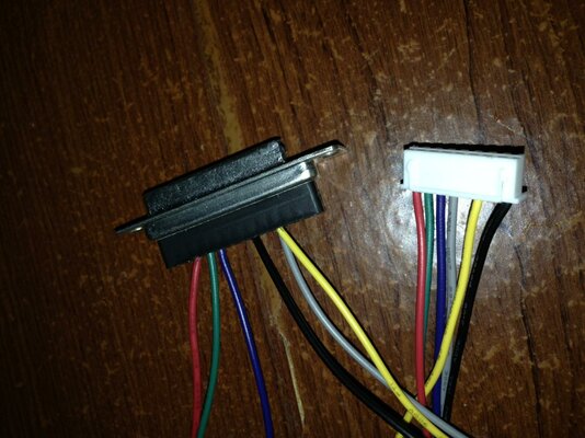

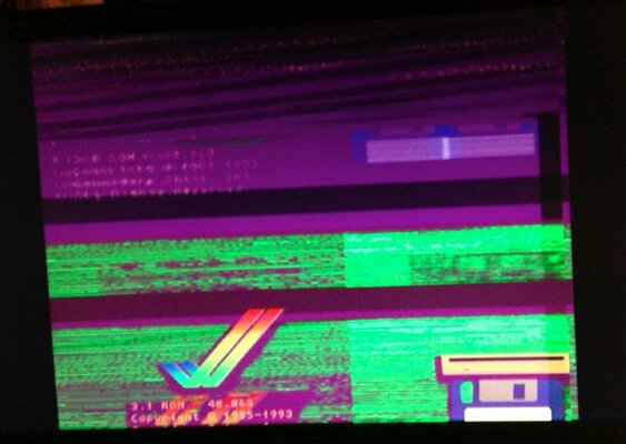

So I tried it and so far no luck.
With the adapter 23-15 from Amikit, if I plug the VGA in, I get no signal (tried to change the input, nothing). Figured out from the documentation, that the VGA in accept only 30.5-32K,which is not what the Amiga output. The alternative is the other input
So I used the cable included; cut a VGA cable and hooked up the wires, as requested (Red, Green, Blue, Ground, Hsync and Vsync) by the board (the colors for the Hsync and Vsync were not the same, so I went ahead and tested each pin with a multimeter, to be sure, comparing them on the VGA pinout). BTW Diskers, your pinout is correct; opened the 23 to 15 adapter and it match.
Now in this way, I get something: when I push the auto button, the card find the signal, but it is unusable, since it flickers and move around (attached a picture to give you an idea).
Do I have to change the settings on the board? Looks like there is some sort of vertical and horizontal refresh setting to do, but the whole thing is in chinese, so I have no clue what is says :)
Did I made a mistake with the connection?
Also another thing which is strange: when I power up the amiga, if the video cable is attached, I get no boot, and the green power led flash slowly, like when you get a guru meditation, but it doesn't reboot...just continue to flash steadily, pulsing slowly.
If I detach the cable, turn it off and on again, it boots fine; after that, I can plug the video cable without problems. No idea why it does that.
NExt weekend I will play with the scart adapter, but for now I just have this. Any suggestion is more than welcome, since you already have the board configured :)

How are you powering the GBS? The image you are getting is due to a power overload supplied to the unit normally.
You can get the correct 2A 5V PSU that will work perfectly with the gbs from eBay for around £2.
Or alternatively wire the power pin from the Amiga port to the other gbs power cable that came with it. Many don't recommend doing that, but it does work. I've used mine that way perfectly ok.
Btw, have you read through the pinning thread about flickerfixers? Loads of discussion about the gbs and how to wire it correctly.

The unit is powered with a 5V 2A AC adaptor, that I use for various other 5V devices (is one of the multi voltage ones; checked the output and it fluctuates between 5.1 and 4.9V).
The video port does not have enough power for the board...it is suggested at least 2A, while the Amiga video port output max 100mA (unless the data sheet that I have is incorrect), I have an ATX adapter, so I can try to get the 5V from the molex for the HD; I have few cables that has the molex connector to get power for the fan; I can use these cables to power the board and the Amiga at the same time.

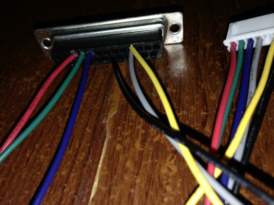

Roy: then there is something wrong at this point with the board? I've got a 25 pin connector, cut it, crimped it with pin 3 for red, 4 for green and 5 for blue; then pin 10 on grey cable (some says to put grey and yellow together, others says that grey is enough), and pin 20 for black (ground); plugged in and now the best that I get is a green screen with some noise on it :(

hi just the grey is needed
also try connectin to the other grounds
you may need to adjust the settings on the board as I did when I first had both of mine
also look at harrisons flickerfixer thread
Roy: then there is something wrong at this point with the board? I've got a 25 pin connector, cut it, crimped it with pin 3 for red, 4 for green and 5 for blue; then pin 10 on grey cable (some says to put grey and yellow together, others says that grey is enough), and pin 20 for black (ground); plugged in and now the best that I get is a green screen with some noise on it :(.
grey is enough

The GBS spec does state it needs a 5V 2A adapter, but in all my tests this overloads the GBS and creates scrambled screens. These range from seeing the image, but with lots of snow. A green and black rolling screen, and a pink broken up screen. All of these issues were due to over voltage.
Now I know the Amiga video port does only supply a very low mA, but it does actually work and powers the GBS perfectly well using the power cable that came with the GBS.

The VGA port on the GBS won't work with the Amiga using a 23pin to VGA adapter because that port isn't for that type of signal. You have to use the supplied cable and make your own cable. Looking at your wiring image remove the yellow wire from your 23pin connector as it won't work with that connected. Everything else is OK, except I also found it didn't work until I joined all 4 of the ground pins together, with any one of the pins connected to the black ground wire. It then works perfectly.
I see, so basically they got it wrong even on their manual....I need less power and not 2A? Will try to hook up the power cable that came with it on the video port.
Also do I have to hook up all the other grounds? (16 trough 20); all the posts that I've found here were just mentioning one ground, maybe that could be the reason why it won't work!
Will try today (without the yellow, since it is not needed). Thanks a bunch!
you already have one ground (black) it is enough
