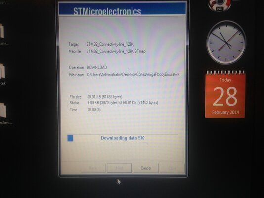

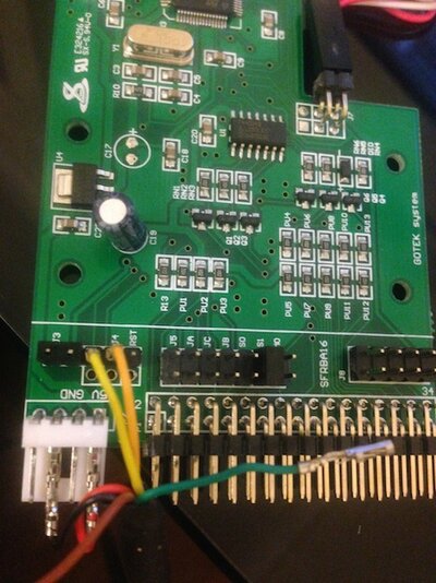

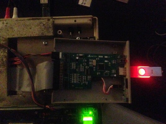

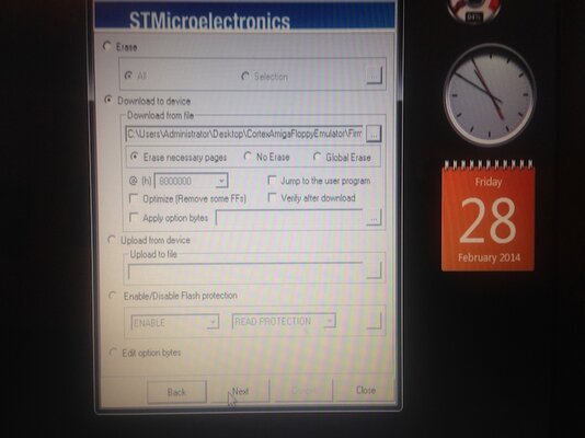

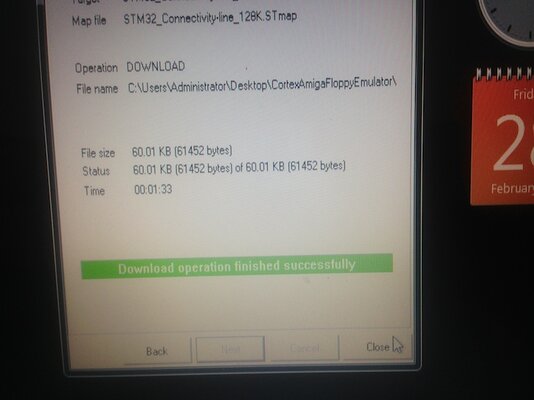

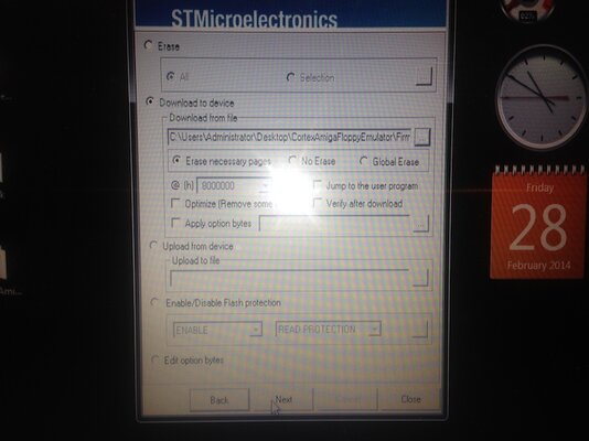

ive flashed the Gotek floppy emulator with the modded firmware today and i thought id so some pics of the process.
flash the firmware , move the emulator jumper to S0 and copy selector.adf to your FAT usb drive and away you go..
mike :-)

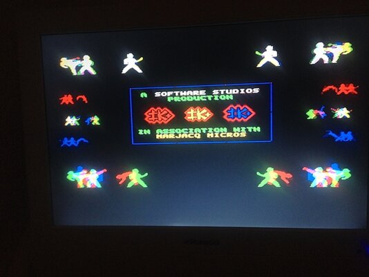

IK+ running on an A500

Hi mike what is did you use to flash the emulator
As I had to use xpmode in win7 as it wouldn't work in win7 32 or 64 or win8 32 or 64
yes i use that program but what flasher driver do you use
Windows7 loaded it by default , i didn't need to select one...
there is a notice on the adapter site saying there is counterfeit 1s being sold from china so mine well be 1 but mine works fine in xpmode so i will leave it at that :thumbsup:
i have flashed 2 fine so im ok
