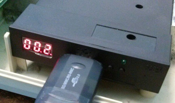

I've recently been playing with the Gotek floppy emulator, and found its complete silence a bit disconcerting - so I came up with a modification to add head-stepping clicks using a piezo sounder.
Here's a prototype in operation: https://www.youtube.com/watch?v=e-nhcgALcDE
I have three units for sale (in black), with the sound modification done and the programming headers added. Please note: in accordance with the wishes of the developer of the Amiga-compatible firmware, these drives are no longer supplied pre-flashed. You wlil need to upload the firmware file yourself using a suitable USB-TTL adapter.
More units are on order so please declare interest here if you'd like one.

(For anyone unaware of how to use this, you need a USB flash drive containing the selector.adf file from the firmware archive found on this page: http://cortexamigafloppydrive.wordpress.com - and also ADFs of the disks you want to emulate.)

Please note: in the first batch, I wired the piezo sounder to the 12v pin on the Gotek unit. This works fine when the drive's in an actual Amiga, but it turns out most external enclosures don't bother connecting that pin, so the sound mod in batch 1 doesn't work in external units.
For batch 2 I will wire the sounder to the 5v pin instead (at the cost of a little volume)
I also discovered another quirk of the sound modification: because there's no drive select circuitry on the sounder, the drive sounds happen when any floppy drive attached to the system is accessed, not just the Gotek unit!
