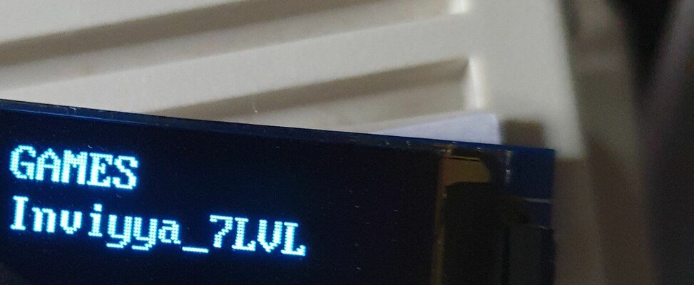

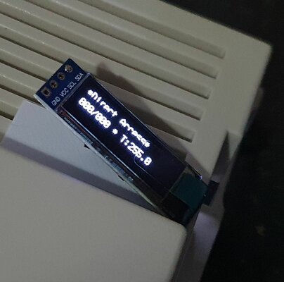

I just installed an oled screen on my Gotek and the bottom part of the text is broken. Is this a faulty screen or possibly something else?

It looks like you have double-height characters selected so you should check your FF.cfg settings. Make sure you have the correct screen, font and arrangement settings.
e.g. From a Gotek with a 0.96" screen, yours is the smaller 0.91" screen.

I think you could be right. This was running with the classic HxC_Compat_Mode without a FF.cfg present. I will check (fingers crossed).
@miggymad i tried, but no joy. I bought the screen years ago, but never used it, so it was either faulty when i got it or it has somehow developed an issue while sitting in an esd bag.
Thanks for trying to help (y)
No worries, it was worth a try.
I might have a spare that you can have... Need to go through my spares boxes and check - pretty sure I saw one lurking just before Christmas.
