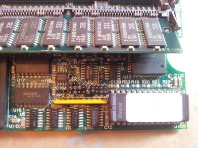

Hoping someone has some advice, I've been struggling for a while now to get my Jaws 1 (MK1 not the Jaws II) to work properly.
This is the model in question: http://amiga.resource.cx/exp/gvp1230mk1
To cut a long story short I had this for ages sitting in a box unused as I never had the memory and recently I sourced two proper GVP sims from different suppliers (1 x 16mb and 1 x 4mb)
However I am stuck, I cannot get either or both to register with the board.
The board will boot, register and under sysinfo list the 68030 /40 on my 1200 but no matter what combination of memory I try or jumpers I cant get it to pick any up.
I know the largest is meant to be in slot 1, tried that, then in slot 2. Then I tried the 4mb one on it's own in both slots still no joy.
his concerns me a bit as it should pick the 4mb without too much fuss, I know the 16mb one needs J5 open so the board knows there is a 16mb module.
From much searching the net I know the "correct" jumpers should be set as follows:
J1 - OFF (For 68030)
J2 - ON (RESERVED)
J3 - OFF (RESERVED)
J4 – OFF (RESERVED)
J5 – OFF (ON – No 16MB SIMMS) / OFF – 16MB SIMMS PRESENT
J6 – RESERVED (OFF)
CN4 – RESERVED (2-3)
CN5 – (ON 1-2 : 4k REFRESH DRAM 16M) / OFF 2-3 : 2k REFRESH DRAM 16M
CN6 – RESERVED (1-2)
CN7 – RESERVED (2-3)
One weird thing I noticed is when I put a jumper on J5 (with no memory and with the 4mb only in) the system would not boot.
Anyone out there with any ideas, does it sound like a problem with the board? I dont have access to another 1200 to test it with but could it be my 1200? It's a model 1D4 I believe.
Power is not an issue, I've been using my old A500 PSU on it and besides it detects the card.
Also since I took that picture I have given it a proper alcohol clean so it's spotless and nothing appears to be leaking or damaged on the board.
Would love to get the card working to get a bit of a step up from my blizzard card otherwise I might consider trading the ram in / selling them and then the card for spares (pretty sure the cpu and other bits might be of use to someone out there). But that's my very last resort.
