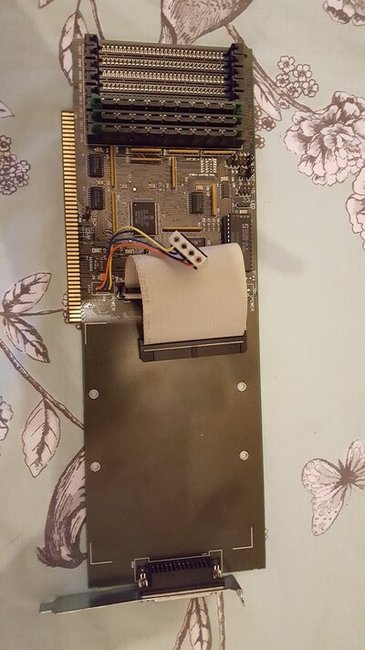

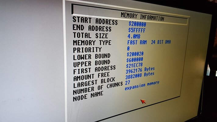

Hi guys got a spare tested working gvp GVP A2000-HC+8 Series II with 3 sticks of memory 4 mb it think will upload a picture of sysinfo later today. fully working just dont need it any more as i got myself a gvp geforce 030. in nice clean condition. i also have a scsi hard drive i can include with this with wb 1.3 on it. but its temperamental i use a scsi to micro sd now.
looking for 65 euro + post for it

Have you tested the fastram e.g. With the Amiga Analyzer? You have to insert 2, 4, 6 or 8 sticks of memory.
I have tested it with the memory I have I don't have any more to test further. It works fine and shows the installed memory. And auto boots hd when attached.
It shows memory that is not installed!!! A working configuration with 3 sticks is NOT possible! If you access the fastram above the first 2 mb (the first 2 sticks) you will get memory errors!
Agree, that GVP card need always even number of memory modules. 2, 4, 6 or 8. Now there is 3 modules. Not supported configuration.

Sorry the card came like this it shows 4mb of memory I don't know everything about amiga just going of what the amiga says on the configuration. It's down to the buyer to do what they want with the sticks that are there. Why not just pm me explained instead of trying to make me look bad.
I apogolize that. I didn't want you to look as scam. Sorry.
As i want that card to my A2k and know how to configure it, it's ok for me =)
- J
Mate, I do not want to look anybody bad, but it is for interest for others, what problem may be with this configuration! :)
The GVP is a wonderful scsi controller, so good luck with your sale!
Had this explained now you will need to configure the card and add or remove 1 stick of memory to avoid errors. There are jumper settings available on line. Hope this is ok now ;)
