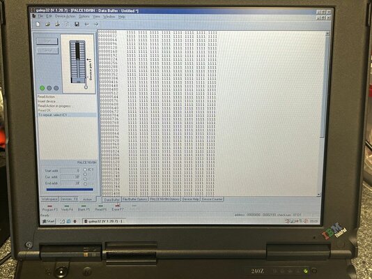

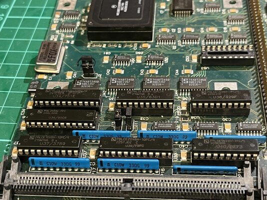

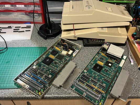

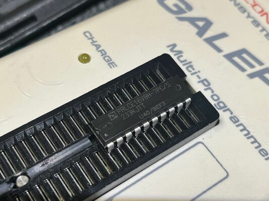

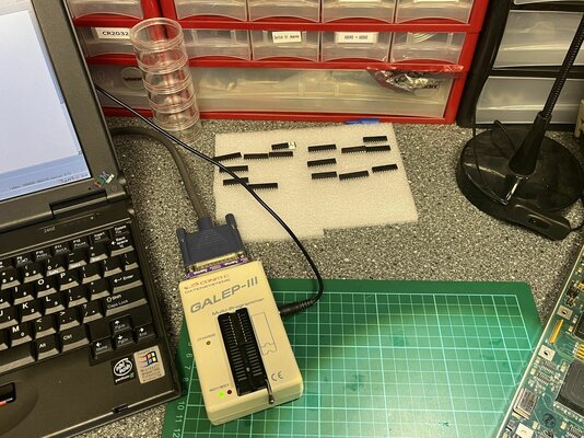

I'm in the process of reading back as many of the infamous PALCE-chips from the GVP A530 as I can, in an effort to compile an archive of fuse map code files for everyones benefit.
So far, I have been through the 16 chips in my two units, and managed to make a copy of the U53 in one of them.
Now, there are eight (8) PALCE-chips in an A530, so I'm nowhere near the target.
However, I cannot find, nor finance, enough units to track down a working set. But my findings confirm the thesis set forth elsewhere on the internet; there is a posibillity to compile a working set of code files, as not all chips have had their seciruty fuse activated properly, making a read-back possible.

I call on anyone with a GVP A530, working or not, to either try and read back these devices themselves, alternatively send the chips to me.
There are several other members here on AmiBay with one or more devices, some working, some not - and all are looking for new chips, either to get a card going again or as backup. But nothing comes from nothing!
Let's keep this thread alive; let me and others know what you think and if you are able to help.

OK, so it seems I'm not the only one where the U53 chip is the one causing the most issues.
In the GVP Combo 030 50Mhz, U53 is a GAL20 - in the A530 it's a GAL16...
So, I've begun to reverse engineer the code for the GAL20 version, aiming to re-code it for the GAL16 needed in the A530.
Unfortunately, it won't be until later this week, or possibly the weekend, before I get a chance to program a test-GAL and see if my second A530 boots with it.

When you read your chips to a fuse map JED file, you can open that file in just about any text editor.
The file starts with a text description of the file and proceeds with contents.
If the contents if primarily "1"'s, it's read protected.
Example from nerdone.it: (data part marked with yellow in the margin)
