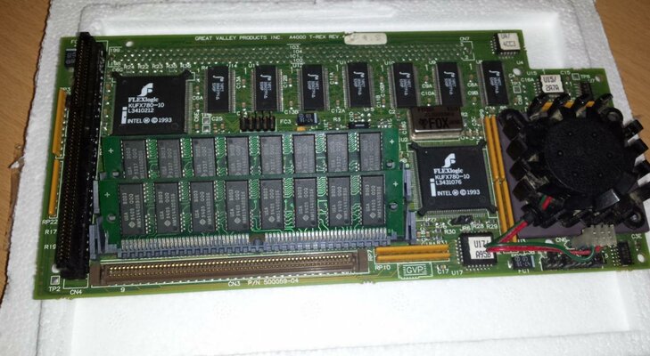

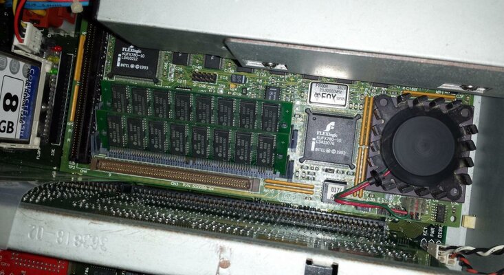

Update on GVP T Rex in A4000
another update on the Trex OK move it over to my A4000 and will run perfect with CWB for 3.1 latest version but will not run with OS3.9 CWB tried memory tried settings on board tried different installs found these settings which help
http://members.iinet.net.au/~davem2/overclock/4040.html
but still no joy with 3.9 anyone got one of these boards anyone have any idea why it would not work my A4000 is listed in my signature.
Speed wise the board is fast but compatibility is poor.
anyone any ideas

Hm, I had one in my A3000D without issues, even no Problems with OS 3.9...
Deling
Jan 24, 2013
1,036
Poland
pl
exactly !! try with GVP original library then will should work ! if not I suspect card or cpu is broken or check voltage 040 need strong 5v

Yeah done that its strange seems to be the piccolo that causes the problems cant use P96 as loads of games wont work Cybergraphics is a disaster that version3 and 4 so a little bit stuck on that best bit is if I dont go with RTG then the system runs rock solid
