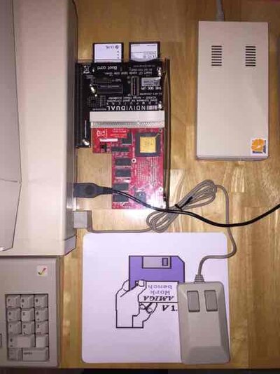

Get the ACA500 plus. Should offer chip ram extension. I have a ACA500 on mine, love it! ImageUploadedByTapatalk1462251824.371024.jpg

Get the ACA500 plus. Should offer chip ram extension. I have a ACA500 on mine, love it!View attachment 105772
