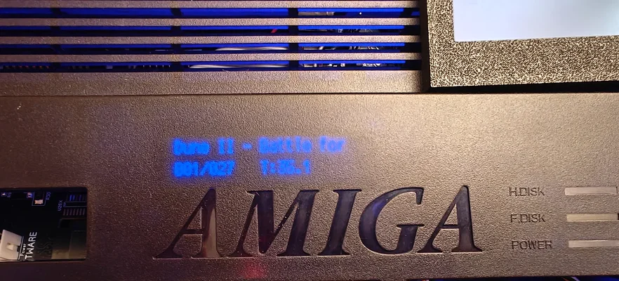

So little update on this, I tried with a couple of different 16x2 LCD modules, and through the case it was very hard to read when the characters were static and impossible to read when they were moving -
So next I sourced a 2.23" OLED with roughly the same screen dimensions as a 16x2 module, but the mounting was quite different, so I filed off the inside of the bottom mounting pegs inside the case, aligned the screen and then hot glued it in place, hopefully that will hold!
End result in the attached image!

@fraser - THAT IS SICK! Which OLED is that exactly?
...I wonder if this OLED light will punch through the black case as well.

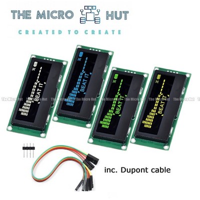

I got it from eBay - this is the listing:
I had to use this in flashfloppy ff.cfg for it to work correctly:
-ztech: ZHONGJY_TECH 2.23" 128x32 SSD1305 OLED display
Must be explicitly configured as cannot be automatically detected

Well done!
I didn't want to butcher those cases myself, either for the LCD or the USB port s, as they are not precut. This is an elegant and clever solution.
