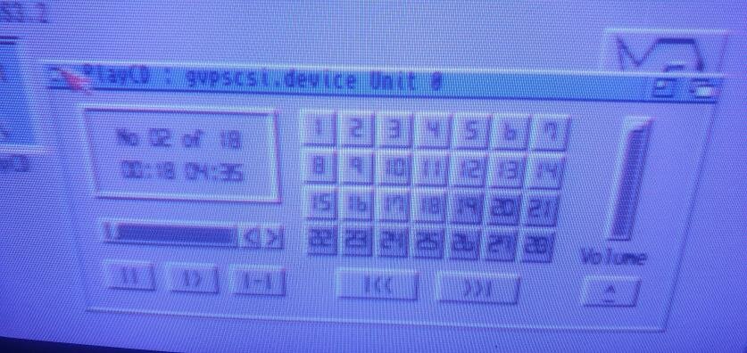

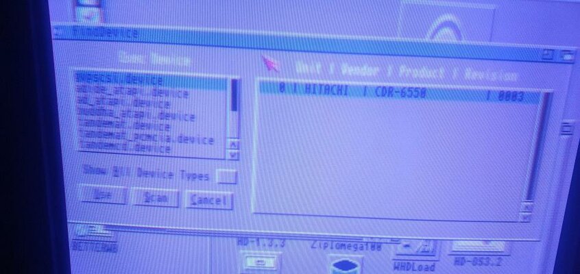

I need your help. I own Amiga500-GVPIMPACTII-IOMEGAZIP-CDROM SCSI 50 PIN. I connected: GVP》 ZIP ZIP》 CDROM with DB25 / 50 adapter. Everything works. IDEFIX or the Install3.2 floppy identify and install the cdrom. As 50 pin cdrom are rare I bought a second one but don't know how to get it to work. I don't use jumpers on my SCSI50 CDROM. The new cdrom is not found by INSTALL3.2 It is found by IDEFIX as UNIT 0, but then it doesn't work I'll explain better. My cdrom, when I insert a data / audio cdrom, the cd icon appears on the screen, but not with the new one, but ..... if I insert an audio CD, it must be identified by IDEFIX CDPLAY. Find the 18 tracks even if you don't hear them and I don't know how to hear them. Why doesn't the icon appear on the screen? help I hope to be understood.

my main problem is not the audio. My problem I explained in the first massage. As you can see from the photos, IDEFIX identifies the UNIT0 HITACHI CDR-6550 cdrom but it doesn't work. and CDPLAY identifies the audio cdrom but does not identify the data cdrom and nothing appears on the screen when I insert a cd.

when I insert audio CDs, after many seconds and almost never at the first time (I have to open and close the door, maybe I am impatient?) CDDA appears but if I click the audio player does not open. How do I do like x the PC?
If I open IDEFIX CDPALY, after a few seconds, 18 tracks appear and it starts reading and I can go on, change audio track etc .. but it is not heard. (Should I put audio cado and how is where?).
The new cd seems to work .... but only with audio cds and not all of them. I have to understand if the 2nd audio cd is damaged .. or the scsi player is sensitive.

My working cdrom player is: NEC CD-3010A
the new broken cdrom player is: HITACHI CDR-6550
Found the manual for the NEC drive. Full range of CD discs support from what I'm reading - http://www.synthmind.com/NEC_CD-3010A.htm
Unable to locate any useful information on the Hitachi drive....very curious!
It might be wise for you to find somebody (in Italy) who can plug that Hitachi drive into something like a Squirrel SCSI interface or into a big box Amiga and run some tests. I have a suspicion that the drive itself is faulty but without it being tested I can not be 100% certain.

AFAIK, this Hitachi drives is a really old one, pre 2000 make surely.
Seems to me that the GVP controller doesnt like them at all. :(
