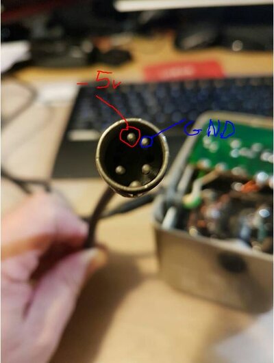

Hi, tried the psu with a multi-meter before hooking it up to the C64 but no joy... I get - 0 from any of the pins.
Any suggestions?
Check the fuse ? Make sure you are testing AC pins and DC pins with correct setting on your multimeter and make sure your probes are insulated.
What did you use as reference/ground? The shield?
It might also be dead, so you could check the fuse.
Fuse tests and looks OK.
I'm using the connector's shield as ground.
Multimeter is set to measure DC 20V as in pic.
Sent from my SM-G935F using Tapatalk

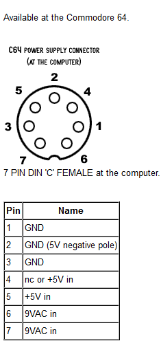

I am not 100% sure that the shield can always be relied on being connected to ground from the PSU, so you better check its continuity against the Gnd pins inside the connector:
Could I check it inside the psu?
Also my connector only has 4 pins, I managed to measure -5v between the two below but can't really measure the other twos...
the pins that are wider apart are ac,the ones closer together is 5 volts dc

Ok, thanks! Measured 11v AC between the top ones (wider apart) and -5V DC between the bottom ones.
Am I good to go or do I risk frying the C64? :D
If you measured -5vDC then you have the probes the wrong way around.
You are ok with these voltages and can try
Yeah, sounds good to me. The 5VDC supply should be stable even without load, but the AC voltage will be too high without load and 11VAC as you see is normal.
