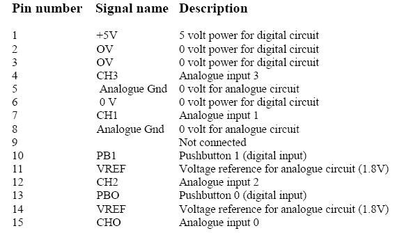

Hi,
I am looking for some help with adapting a 15-pin PC analogue joystick to an Acorn Electron 15-pin joystick port. I understand that the Acorn pinout assignments were decided before the pinouts of the PC MIDI/joystick port were agreed, so although they share the same connector, they are incompatible; all of the required signals are there, but in the wrong sequence...
Is there a BBC Guru (Maybe TC) that can help me put together an adapter that can allow me to use a PC joystick (or possibly a joypad) on the Electron? I have the pinouts for the Electron and the PC pinouts are easily found, but the Plus 1 Interface manual for the Electron doesn't describe them in the same language as the PC port.

Here is the PC game/MIDI port. But for the Acorn/BBC I just found a .PS document that I'm unable to transfer to Amiga now for proper reading.
Anyway, here goes the pinout from said document via Google HTML:
Code:
Pinout:
1 +5V
2 0V
3 0V
4 CH3
5 analogue ground
6 0V
7 CH1
8 analogue ground
9 light pen strobe (not LPSTB)
10 digital switch input (I1)
11 voltage reference (VREF)
12 CH2
13 digital switch input (I0)
14 voltage reference (VREF)
15 CH0

Here's what I got from the Electron Plus 1 Manual; it's not the same as your list....
[attachment=0:7364wwb2]Pinouts.jpg[/attachment:7364wwb2]

"My" list and yours are the same...

So why is pin 9 on the list I have not connected, then?
