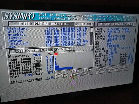

This 1200 has two distinctive issues that manifested themselves at the exact same time.
One is that I'm getting some kind of interference on the picture as seen in the picture below. It's constantly rolling up.
The other issue is that I'm getting GURU Meditation errors. 8000 0004 right upon booting Workbench. 8100 0005 or 8000 0003 when trying to start WHDLoad games through AGS.

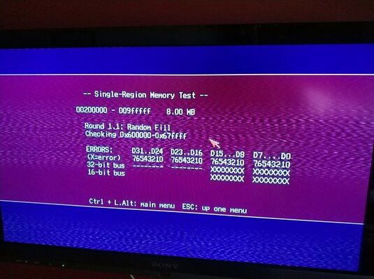

Ok, so far it seems the guru errors are related to the expansion, so I decided to get Amiga Test Kit from the website and test the FastRAM and I got errors, as I expected.
Oddly enough, seems that the whole 16bit bus is "erroring" out and only on the upper Zorro II address space, but this was expected, as setting to 4MB tested fine. I decided to test in 512KB chunks from 0x60000 up to 0x9fffff, the results were unexpected. Every single test yielded the same exact errors, seems unlikely that both RAM ICs are dead, and if they were I'd get a bit here and there that would fail, not the whole bus. Could it be a failing CPLD? I tried direct memory detection on ATK and it detected the whole 8MB of RAM.
