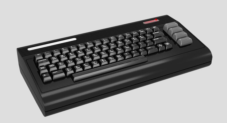

Hi
i have a really nasty yellowed C64 breadbin.
The replacement key caps indiegogo has a render of a glossy black case.. I want one!
https://www.indiegogo.com/projects/brand-new-colored-keycaps-for-your-commodore-c64--2
how would I best etch(?) and prime and paint a plastic case black?
I need to do a good job on it and I will need to practise.. anyone please suggest what to use and how to do a good job of it?
cheers, iain
