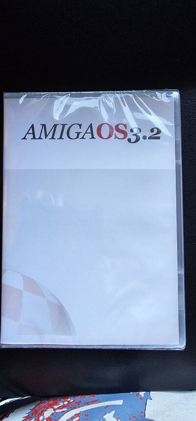

Also, be careful not to toss out the plastic wrap--the serial number is on that (and not on the CD case itself). The installer won't ask for it, but you need it to download anything from Hyperion.

Where's this serial number meant to be? There's nothing on mine...
It's usually stuck on the plastic cellophane that you rip off the box and throw away ... clever huh?
