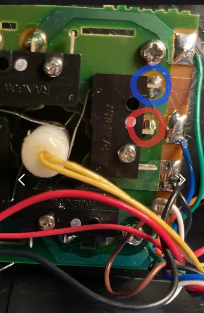

However, i have this one on my desk, so called SwitchJoy. Can't remember where i got it or if it is for the Amiga.
Unfortunately, left direction does not work, up and down are hard to get, only right seems fine. Both buttons are the same and there is an autofire switch.
Inside it looks like this, with lamella contacts.
Could someone with experience guide me about how to repair this?

joysticks are really simple devices
i would ohm out the cable first(the individual cores),then the switches,that gives you some idea what to repair
as those are the two main failures in most if not all joysticks

To check continuity of the cable, can i just plug a probe into the DB9 connector and the solder joints on the board (sorry if that looks like a dumb question)?
yeah if itll fit in the joystick end,have a notebook at hand to keep track of the pins tested,some might not be connected at all,by that i mean it probably doesnt use all nine pins
you can see where the wires go,so just test one at a time
and the switches are easy as well,a probe on either side of the switch and actuate it,the meter will tell you if its working or not
Check continuity of the cable and push the left direction switch with your finger to see if the switch responds to the end of the cable. If it works ok then maybe the issue is in the end of the connector.
Click the switch and check for continuity between blue and red circles. (possible switch problem)
If it is ok, check between blue and wherever it goes to the 9 pin connector. (possible cable problem)

Indeed there is continuity between all red and blue circles of the switches, then there is still continuity between all blue circles and another solder spot on the board.
Now i am currently trying the DB9 connector to the board.
Actually, only pin 8 has continuity to something. All others are not beeping to any of the spots on the board. However, wires seem fine to the eye.
Pin 8 goes to right switch.

Pin 8 is groung and should have continuity to all middle legs of the switches. But it is very weird that nothing else is working.
Test again and yes, you may have to replace the cable.

I have just understood that i can remove a cap on the electrode of my multimeter, allowing a better contact in the DB9 connector.
I have found a better schematic
And then only down and left are not working.
8 is ok with the middle leg of all switches as you said (stupid me i wasn't trying that leg).
6 is ok with the solder joints of the second button, but both act the same on this joystick.
If two wires are broken somewhere, i guess i still need to replace all the cable.
Move the joystick downwards and see which switch is activated.
Upload a photo of this switch or check yourself if anything's wrong.
Downards activates the upper switch on this picture and it is connected to the blue wire. Actually, it seems to still ohm 1 out of 10 tries between the pin and the solder pad, so maybe i should redo the solder job of the blue wire.
Stick to the left activates the switch on the left of this picture taken from below, which is green wire.
No matter how many time i try pin 3 does not ohm to the green wire solder pad but there is continuity between the switch and the green wire solder pad.

What confuses me about the "green wire" switch, is that it seems that the ground is not on the middle leg.
I have somewhere exactly the same joystick. I will take a look at it and I'll come back tomorrow.
Indeed, on the PCB, the trace is from the middle leg of that switch to the pad with the green wire.

Thanks. So what can i do? Resolder green and blue?
I guess this is not your problem.
When you test the pins of the connector, how do you do that? Do you use dupont cables?
If you just push the probes inside, it is not reliable enough. The probes may not touch the pins.
