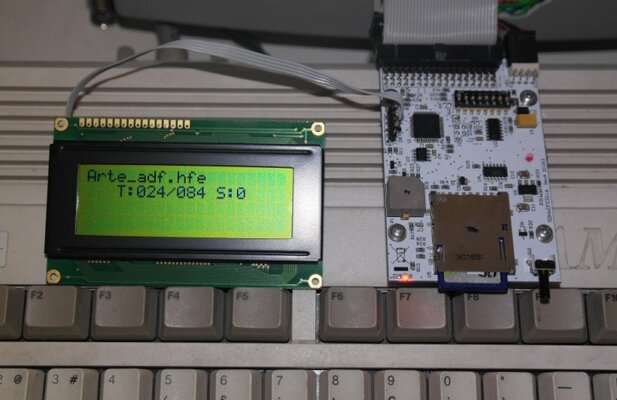

Wait a minute : There IS a Header for LCD screen and buttons -> J3 !!!
The I2C LCD screen can already be buy on ebay for some $ / euros.
Just let me some time to work on the firmware.
The Slim LCD / Frontpanel connection is a lot better than the old hardware solution. It will even be possible to connect an overlay board to display the things directly on the CRT screen ;)

The firmware have now the external I2C LCD support (available for some $ on ebay)
