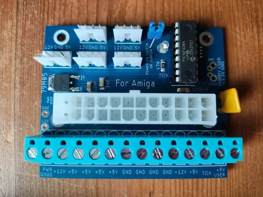

First clean up the motherboard after removing that battery.
Some vinegar and alcohol 96% should help, then test it to see if it's working.
You are going to need something to display it, so a 15Khz monitor can do the trick, but there are also loads of adapters that can convert the signal to HDMI.
If it is working, then have the motherboard repaired professionally and certainly the PSU capacitors replaced.
But it is generally better to have an ATX psu in there, cause the Commodore PSU's are not good, even if it is fully overhauled.
Once that is done, you can start thinking of upgrades.
