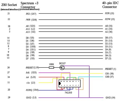

you say about converting from 16bit data to 8bit data, but the IDE interface can be driven by 8 bit data and only few address/command lines (a0,a1,a2 or pins 35,33,36 on the IDE side) as well as a few others
if the apple II interface has direct Access to data,address,cs,WR,RD lines as well as a few others then you could build a non bootable IDE interface quite easily.

The simplest IDE implementation, taken from http://www.worldofspectrum.org/zxplus3e/interface.html#simple

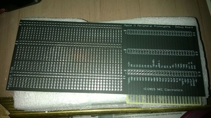

I bought an Apple expansion proto card for my project. Have to continue with the schematic now. Also have to find the datasheets for the 65816 and the Atmega32.

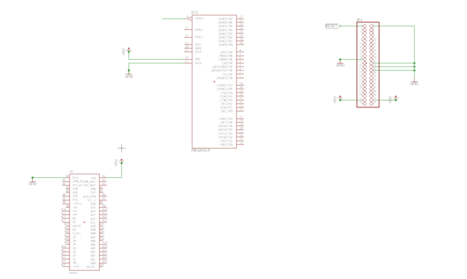

Thanks, Pghulme! I installed the library and managed to create a variant that has the pin assignments like in Apple 2.
Here's a screen capture what I've made so far. It's not much but a start.
Looks good :-)
we we all got to start somewhere, keep me updated on how you get on and if you need any help feel free to let me know
