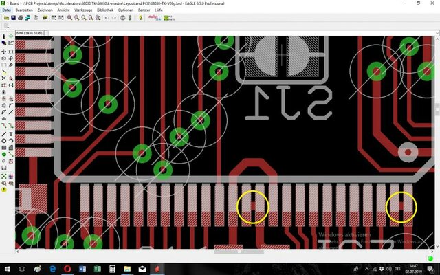

Guy's should any one the pins be shorted on the lattice chip (CPU board). Because I see 2 legs that are shorted...
Yes, they should on each side except right side
Oh Ok.. Can I please send the board to for you to see whats going one with it SOB!!!!
OOO Thanks please PM me your address, and I'll pay for the repair..
