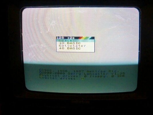

So does it all work ?
Well yes it does... wanna see?
as the Spectrum booted up - there it was that "1 Floppy, 1 IDE" - whooho :thumbsup:

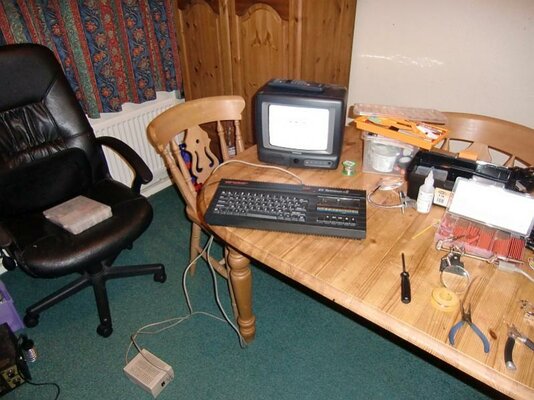

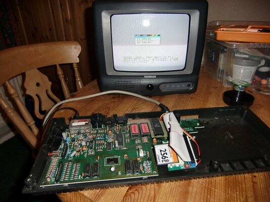

Keith old chap, I finished the first of the PSUs earlier and used it to test out the +2a you gave me when I got back from Afghan.
It works a treat, I'll get the other PSUs finished up in the next couple of days.
I also bunged in the 3e ROMs, and the IDE adapter, soldered in a power cable, and installed a CF-IDE adapter with 256Mb card and it fires up no problems whatsoever.
Its nice to have it sat there with nothing dangling out the back, and only a Power and RF cable. Neat and tidy. ;)
I'll set it up properly next week, and it'll be good to go.
Cheers for the bits and pieces. :D
