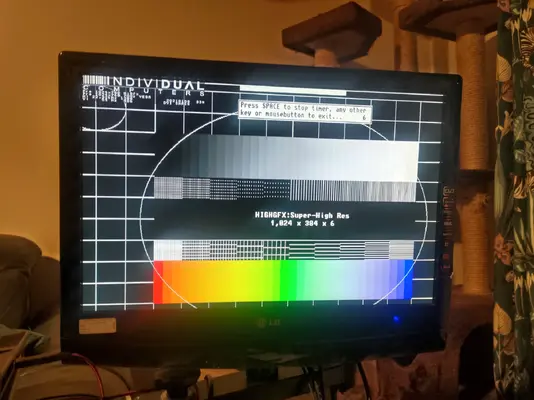

Indivision AGA MK3 A4000D - A4000D CD32​
This unit has developed a fault, image is being overlapped multiple times., please see photo.

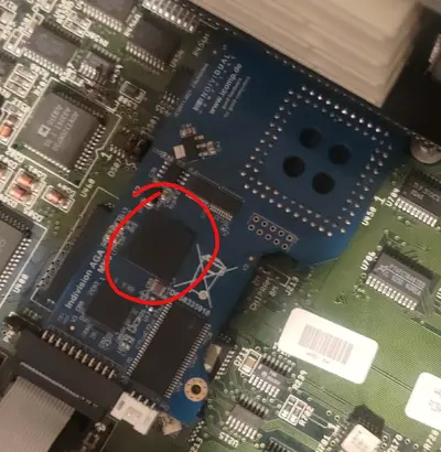

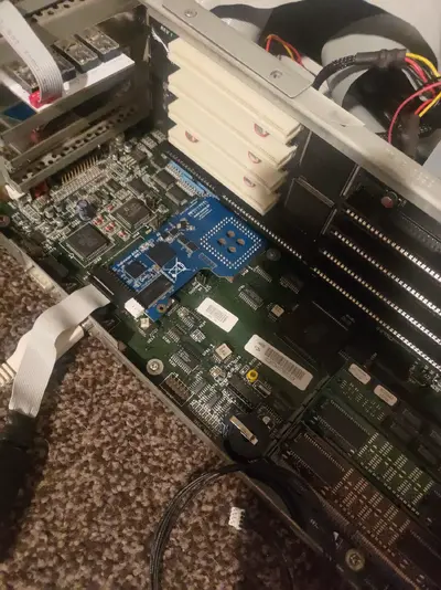

Indy MKIII AGA A4000/CD32 arrived today Thanks for quick shipping
Tested on my A4KD and Indy exhibits the fault shown with a jumpy picture; however, the Indy logo is rock solid, so I thought it must be an issue with the decoding side, rather than the output side.
Think I found the issue with one of the ICs because when I lightly pushed down on it, the picture became stable so with my hot air gun and some flux I reflowed that IC and on test, no jumpy picture going to leave it on for a while to see how it fares but so far so good
See attachments for the picture of the IC in question which I pushed down red circle around it
A bit disappointed you have to bend a set of Jumpers down and out of the way to fit it in, bit of a design flaw there.

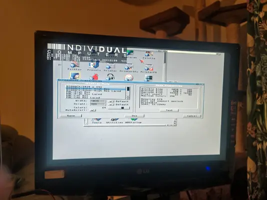

Update: Picture has been stable for over an hour but if I push the board in certain areas I get the jumpy screen however I have to push the board in a different place for it to happen so somewhere there is a loose connection but its now the other way around I have to push the board to get a jumpy picture 😆
What I'm going to do now is leave it off and try it again tomorrow to see if when it is cold if we are back to the same issue.
