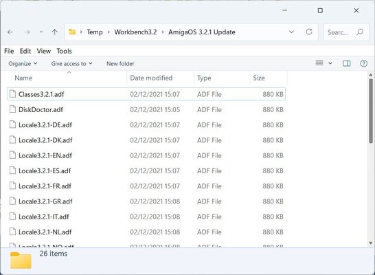

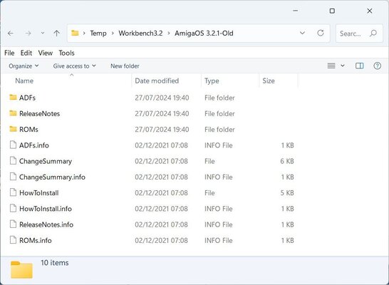

If your system is borking after installing the 3.2.1 update then go check the update contents itself. Do you have the version that are all digital adf files or do have one that contains the file 'ChangeSummary'
To be honest, it shouldn't make any difference if you have physical ROMs or you softkick them.
I have both versions of the 3.2.1 update. I do use the fully adf versions with my A1200's and they seem to be just fine. I wonder if the hardware config you have there is more compatible with the "ChangeSummary" version ...
