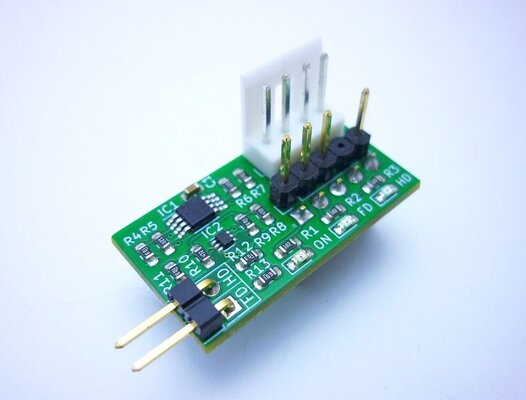

I have seen the Amiga A1200 HDISK/FDISK LED Adapter for sale several places and it seems to work with the PiStorm and Vampire cards, I was just wondering does it work with the TF1260 as well, and if so where would it be connected?
I've got one of these and a TF 1260. The bet thing about it is that it has it's own little LED's which are very cute.
Anyway, yes you can make it work with anything that uses a CF adaptor, the tricky bit is soldering a wire to the correct pin on the CF adaptor (not on the TF)
