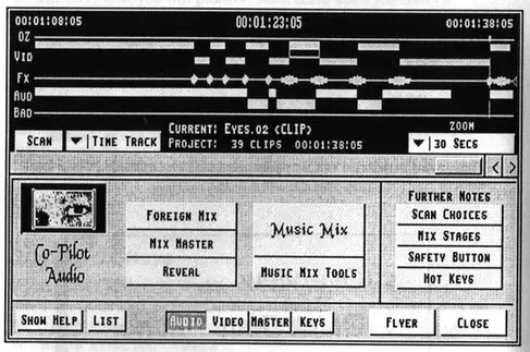

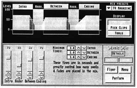

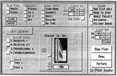

This Co-Pilot Audio software appears to have plenty of potential and capability, indeed turning the Flyer into more capable Audio editing device. Still working within the Flyer audio format however. Considering how many of these Flyer things went out into the wild, it is unusual that the Flyer Zorro II audio hardware wasn't addressed in Amiga audio applications. (Was it?)

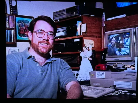

Photos are my first Toaster setup on an A2000 (from the 90’s!) and my current 4000 based Toaster/Flyer.
